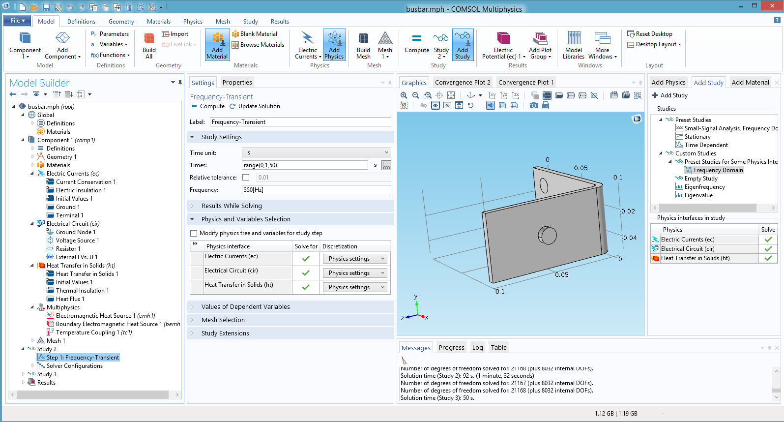

Posted: 1 decade ago 27 mars 2015, 08:38 UTC−4
this is good example, but problem is in frequency domain study.
Temperature doesn't changes with increasing alternating current frequency.
I'm using Frequency-Transient. "Heat Transfer in Solids" interface is supported by Frequency Domain?
Independently of different frequencies COMSOL give the same results.
I would like to obtain temperature distribution depending from current frequency.
Michael
Hello, this is good example, but problem is in frequency domain study. Temperature doesn't changes with increasing alternating current frequency. I'm using Frequency-Transient. "Heat Transfer in Solids" interface is supported by Frequency Domain? Independently of different frequencies COMSOL give the same results. I would like to obtain temperature distribution depending from current frequency. Best regards, Michael
