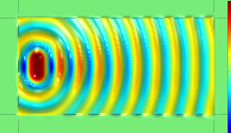

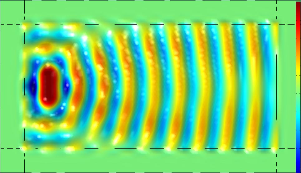

Thanks for answering the question. I am using 4.3b. So I cannot open your solution. I am kind of confuse about your operation. I need to mesh the upper plane with trianglular elements and mapped mesh at same time or you mean I either use triangluar element or mapped mesh to mesh the upper plane. I am able to mesh the upper plane (except PML layer) with free triangular and successfully sweep across the entire plane. However, the result looks not right. see attached vibration out-of-plane displacement field. Any ideas about it.

I looked at your model. I used triangular elements in the center parts where you had them. On the boundary domains I used mapped mesh which makes tetragonal elements. Then I swept them simultaneously. At least in 5.0 it works with no problems. Look at the attached image.
