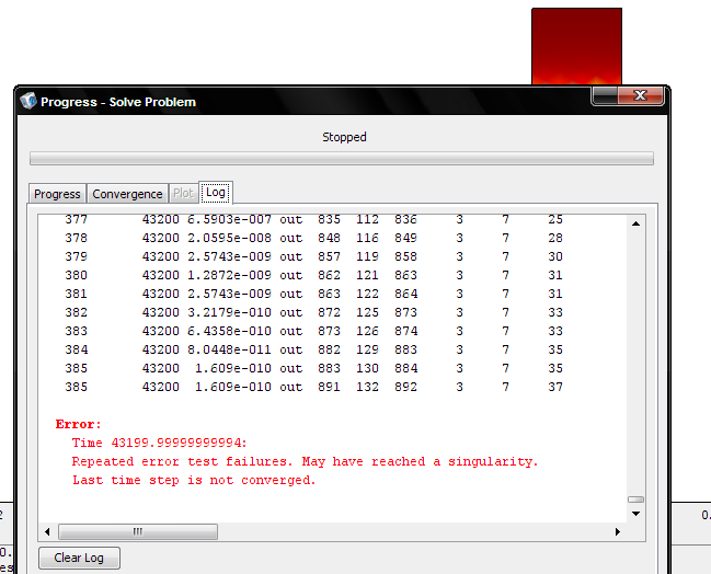

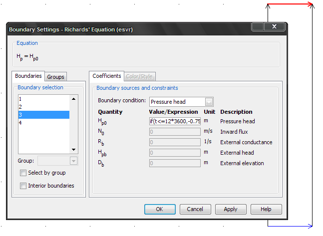

i have a probleme with ' if statement'. if you can help me. (if(t<=12*36000,-0.75,-5))

You should use a smooth step function, if I rember well in versin 3.x it was called "flc1hs".

You can also use the Step function available under Definitions > Functions.
