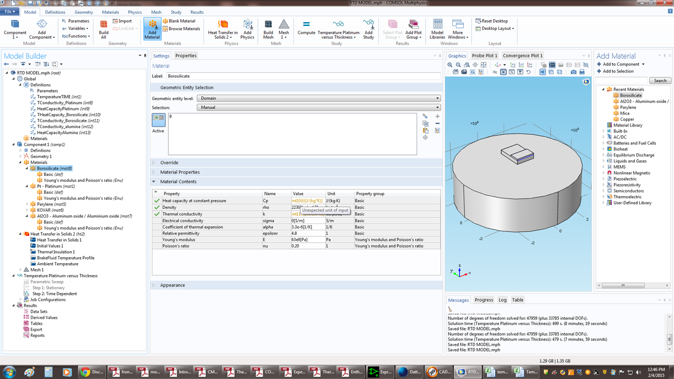

Attached you will find my model, some explanations about what I am doing:
1.- The parameter sweep of the thickness of my parylene layer is being done on the Auxiliary sweep option under Study Extensions tab. I am pretty sure that the error is related to some meshing issue.
2.- I am also including in my model temperature dependence properties, this was done with a interpolation function that is being called in the Materials property section for the corresponding property. However, I am getting a strange warning message : "Unexpected unit of input", although this message is not stopping the simulation I am worry about if this can lead to a wrong result. I am attaching a screenshot
I hope you can help me Lasse
Thanks in advance.
Your interpolation table int1 gives temperatures in degC, try K if it resolves the input unit problem, I am not sure.
Lasse
I will try with the meshing, thanks for your recommendation. Regarding the interpolation table, I already try changing the units and the warning message still there, looks like is not a error because I can run the model without the parametric sweep and get results.
