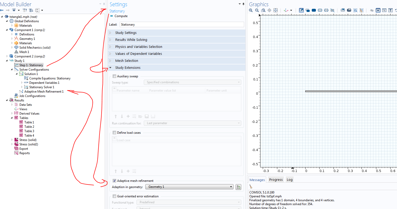

Hello Ivar:
May I know how I can refining mesh automatically using COMSOl instead of doing it manually. In general I need to draw a relationship between change in results (error) and mesh refining.

its all in the solver node, under "Study Extensions"
Check the corresponding doc, it still needs some tweaking to adapt to your model, but start with the default values
