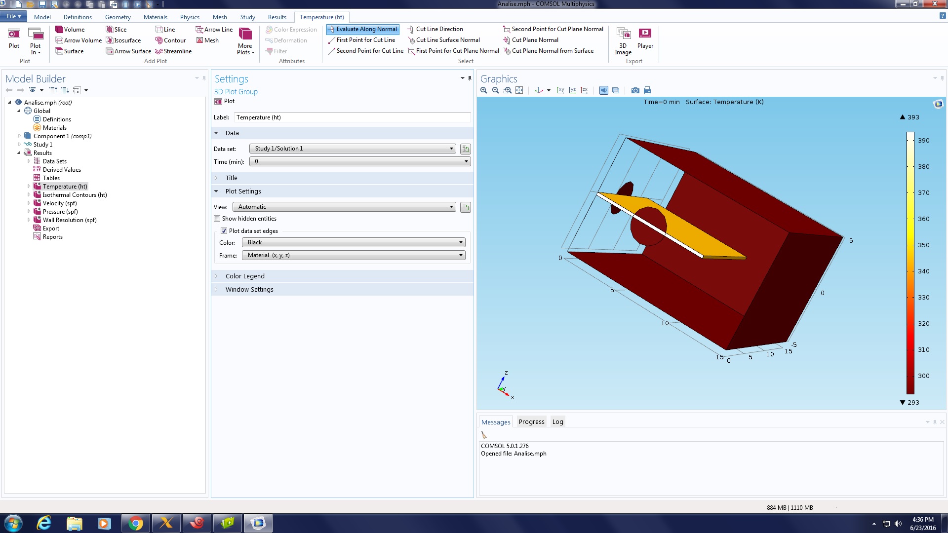

I am having trouble modeling a flow in which there is no defined outlet. For example, imagine 2 hair dryers perpendicular to each other blowing air to a plate. There is an inlet, hair dryer's nozzle, but there is not an specific outlet because its an open system, without a channel for the fluid to flow.
I tried to model that using many outlets instead of not pointing any, but it did not work for laminar flow. Should I use turbulent flow instead? Which type? If the air being blew is cooling the plate, which boundary should be the outflow?
Thanks.

I could figure out some of the problems we were having, but even though I ask for 5 minutes of time-dependent analysis, the solver stops on 0.2235123s without giving any error message or anything. I believe the physics are right but I am not entirely sure. We were using a time step of 1 second, and maybe it is too big. We are testing with a new, smaller, time step. Can anyone help with that problem?
