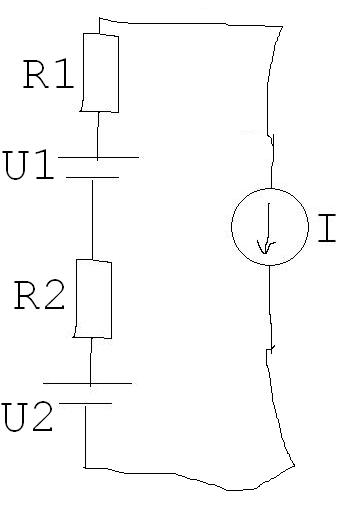

How do I create a distributed voltage source in comsol?
The electrical circuit illustrated in the attached image is a very simple model of a fuel cell stack containing two fuel cells. What I would like to do is to replace R1, R2, U1 and U2 with 2D or 3D structures with R and U being functions of x and y. For R I can easily create solids with their conductance being a function of x and y. However, I can't figure out how to create the distributed voltage sources. Any suggestions?
