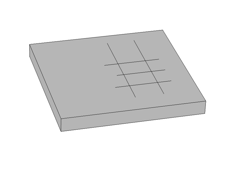

Please look at the attached file. I want to:
1. make the block to be of silicon.
2. the lines on the surface will be carbon.
How do I do this?
P.S. the problem I am facing right now is: when I select the block to be of silicon, the lines turn into silicon by default.
Any help is appreciated. Thanks in advance.
1 Reply Last Post 17 août 2015, 08:46 UTC−4
Mao COMSOL Employee
Posted: 10 years ago 17 août 2015, 08:46 UTC−4
You can assign materials to different dimensions by choosing different geometric entity levels.
Mao
Hi, You can assign materials to different dimensions by choosing different geometric entity levels. Best, Mao
