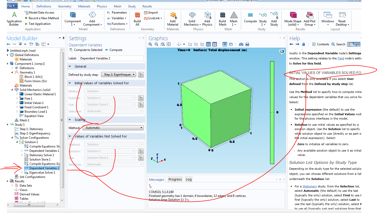

Check the solver node: Dependent variables and the associated Help and/or DOC "Initial variables Solved For"
Try using some of the COMSOL internal combined solver cases as shown herebelow for solid
There is NO restriction that both solver cases must be under the SAME study
Hi Check the solver node: Dependent variables and the associated Help and/or DOC "Initial variables Solved For" Try using some of the COMSOL internal combined solver cases as shown herebelow for solid There is NO restriction that both solver cases must be under the SAME study -- Good luck Ivar

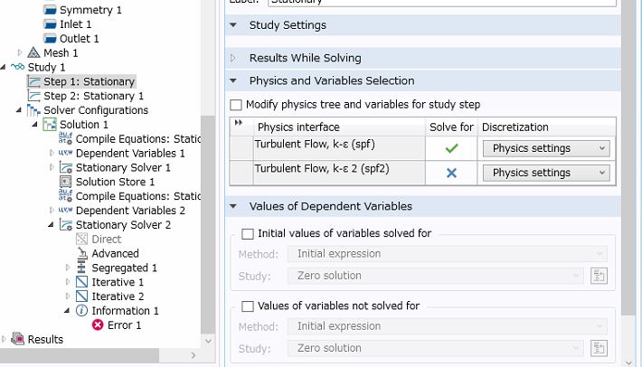

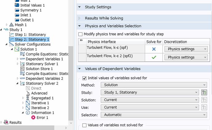

I have set two turbulence model with the same boundary condition. Then I use to steps of stationary calculation in one study. In the second step, I set the "initial values for variables solved for" as follows:
Method: Solution
Study: Study 1
Stationary Solution: Current
Use: Current
Selection:Automatic
And I have tried also to use these two models in two study.
In the second study, I set:
Method: Solution
Study: Study 1
Stationary Solution: Solution 1
Use: last
Selection:Automatic
Are they correct? Sorry for bothering you again!

Yes, I mean that it doesn't converge.

what is the error message when you separate it out into two different studies?
