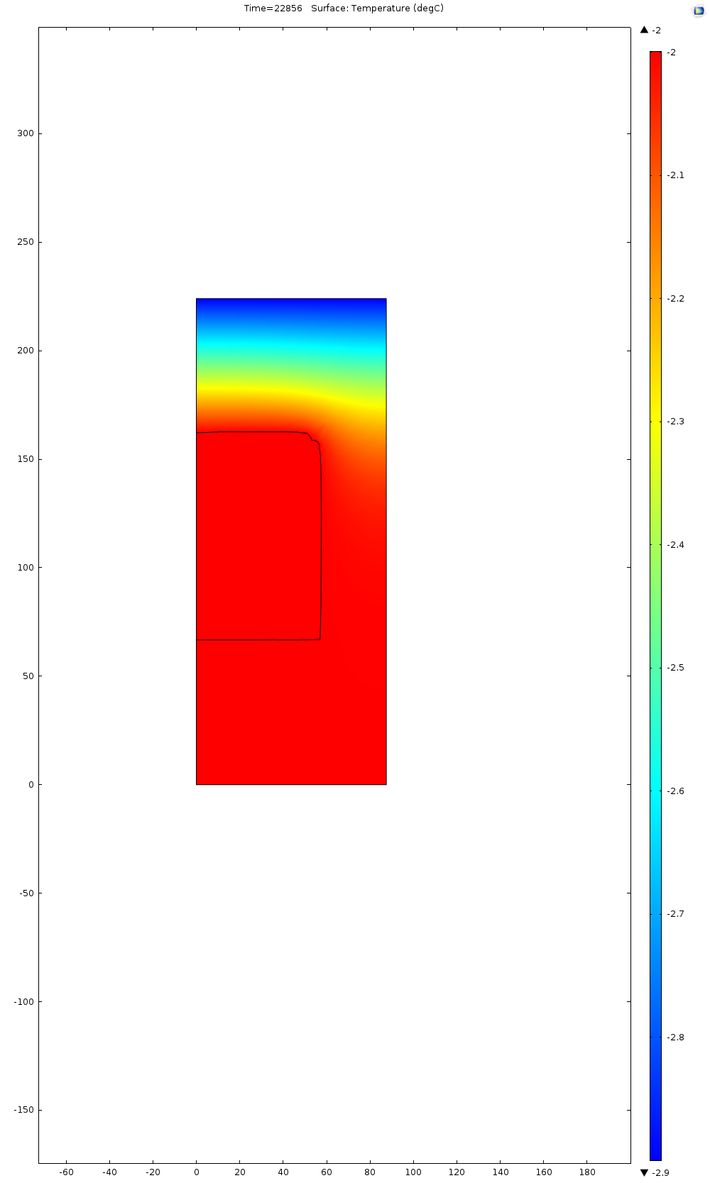

I have modeled an ice sample (filled with water in gaps) in "Heat transfer" module. For right boundary i use symmetry, for surface i apply temperature and for other boundaries - thermal isulation. In result, i want to observe, how the boundary between ice and water move (how ice grow up), so i use "deformed geometry" for all domains and "prescribed normal mesh velocity" for boundaries betwen ice and water.
I can calculate only three hours of simulation, but need three days. I've get error "Repeated error test failures. May have reached a singularity."
I don't know how to make my initial conditions better and maybe something wrong with my step function, but i couldn't find mistake.

The problem comes from your mesh. Don't use boundary layer mesh, velocity is very low.
It's better to decrease relative tolerance is deforemd studies.
Mapped mesh is very good for deformed studies.
I tried with mapped max size mesh = 10 m (joined picture) with relative toerance = 0.001
Be carefull, I think that in Stephan condition the interface must be at a constant Temperature
Julien
Hello, The problem comes from your mesh. Don't use boundary layer mesh, velocity is very low. It's better to decrease relative tolerance is deforemd studies. Mapped mesh is very good for deformed studies. I tried with mapped max size mesh = 10 m (joined picture) with relative toerance = 0.001 Be carefull, I think that in Stephan condition the interface must be at a constant Temperature Julien

Thank you very much! It works now!
