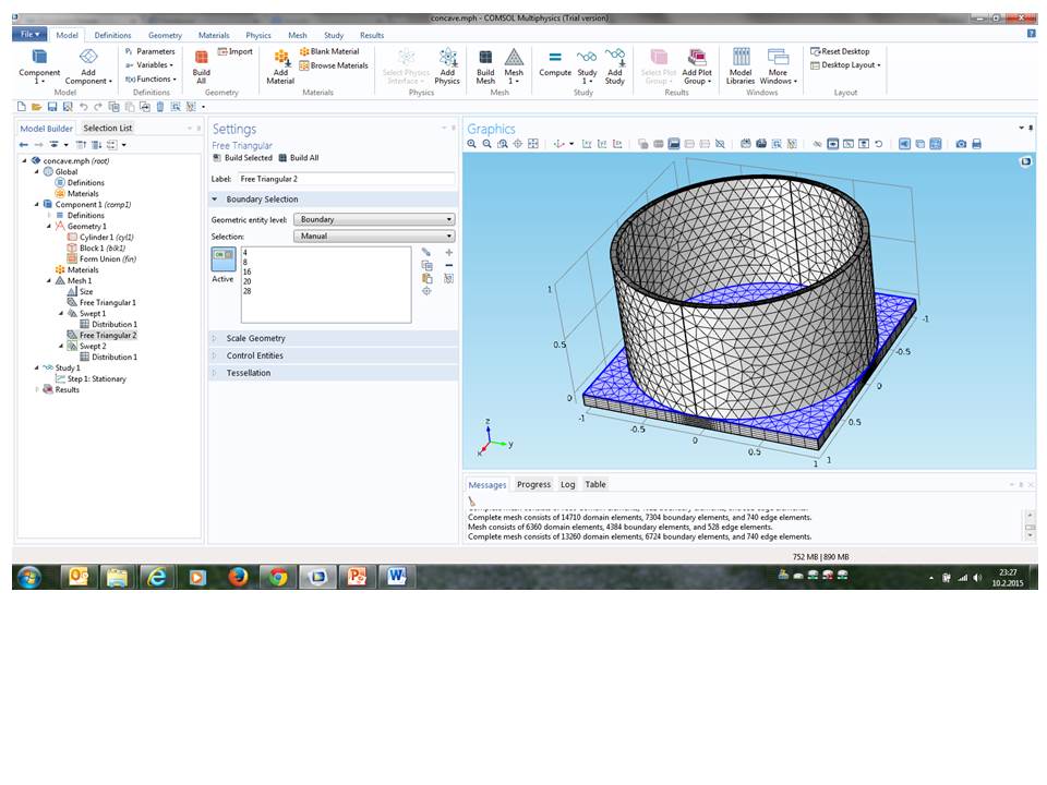

Posted: 1 decade ago 10 févr. 2015, 14:08 UTC−5
Mesh attached.
Mesh attached.

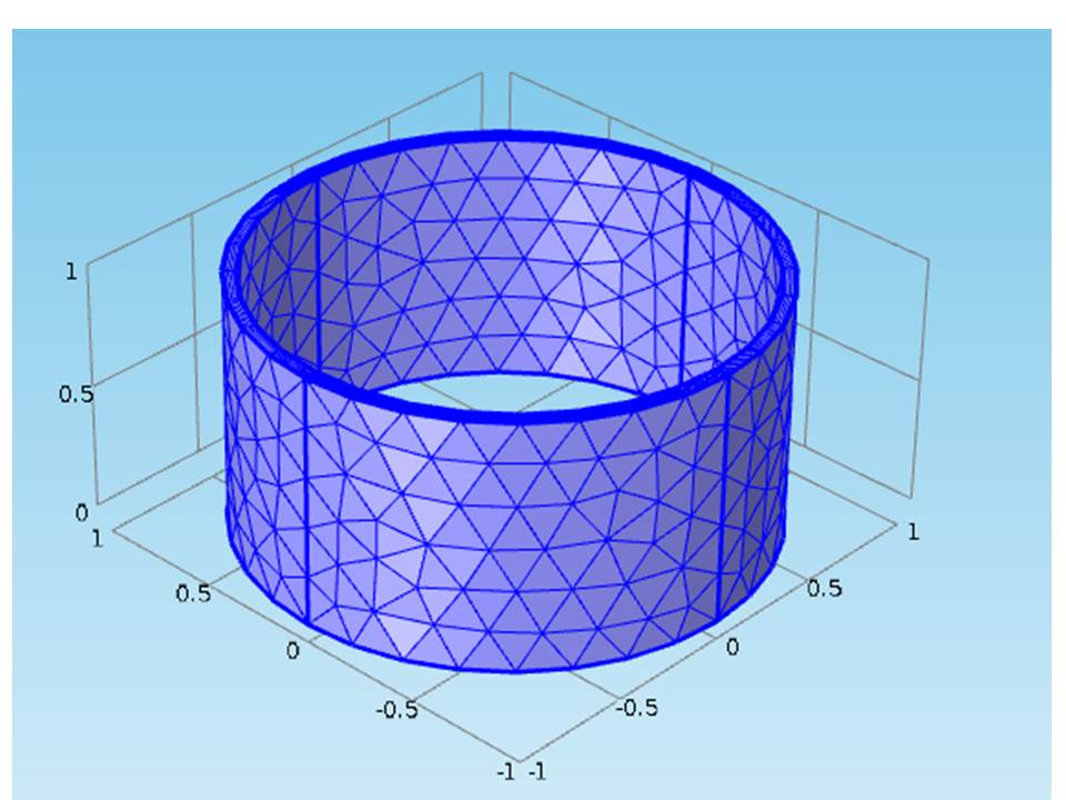

Posted: 1 decade ago 10 févr. 2015, 15:28 UTC−5
No problem, if you first mesh the inner surface. Look at the attached image.
Lasse
No problem, if you first mesh the inner surface. Look at the attached image. Lasse

Posted: 1 decade ago 10 févr. 2015, 16:32 UTC−5
I was wrong, it was rather straightforward. First I meshed the tube, then the remaining parts of the plate surface. Finally swept mesh across the plate.
br
lasse
I was wrong, it was rather straightforward. First I meshed the tube, then the remaining parts of the plate surface. Finally swept mesh across the plate. br lasse
