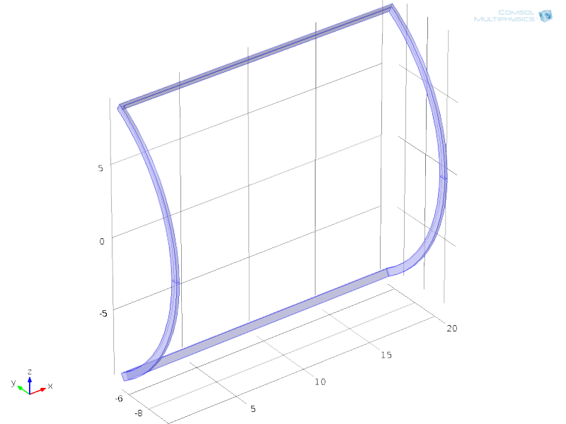

Posted: 1 decade ago 5 févr. 2015, 09:28 UTC−5
Here is a screenshot of the domains I selected for the coil in my model, and I can't figure out why I can't use gap feed to specify current direction.
Posted: 1 decade ago 5 févr. 2015, 10:33 UTC−5
In the model you attached in the first post, the whole saddle is selected and the gap feed extends all across the saddle, which doesn't make sense.
I corrected your model and now it solves. Two more remarks. In mf the non-conductive domains mostly need a small conductivity and you have to add a 'Gauge Fixing for A-field' node to achieve convergence.
Also I would advise to assign a material or realistic conductivity to the coil domain to get meaningful coil parameters in the post processing.
I am attaching the rectified model.

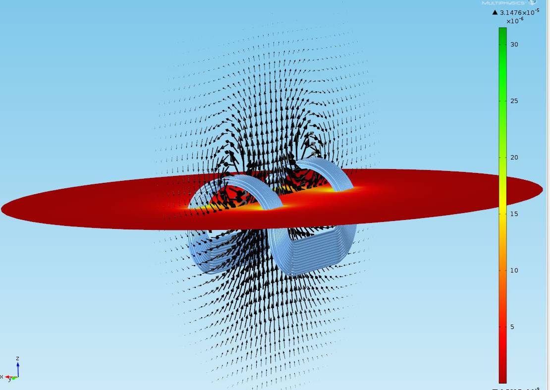

Posted: 10 years ago 13 mars 2015, 18:41 UTC−4
Actually I am trying to design a model of gradient coils for use in MRI. I really need to know how i can design a saddle coil geometry and run the study to get the magnetic flux .
thanks in advance

Posted: 10 years ago 14 mars 2015, 16:00 UTC−4
Well,i checked it , you really did a great job , actually i am beginner and i trying to design a model like the attachment photo , and how i can change the current in the coil to the opposite direction .
Best regards
Well,i checked it , you really did a great job , actually i am beginner and i trying to design a model like the attachment photo , and how i can change the current in the coil to the opposite direction . Best regards
Posted: 10 years ago 14 mars 2015, 17:32 UTC−4
Multiply with -1 ? This will also change the sign of the flux, nothing more.
