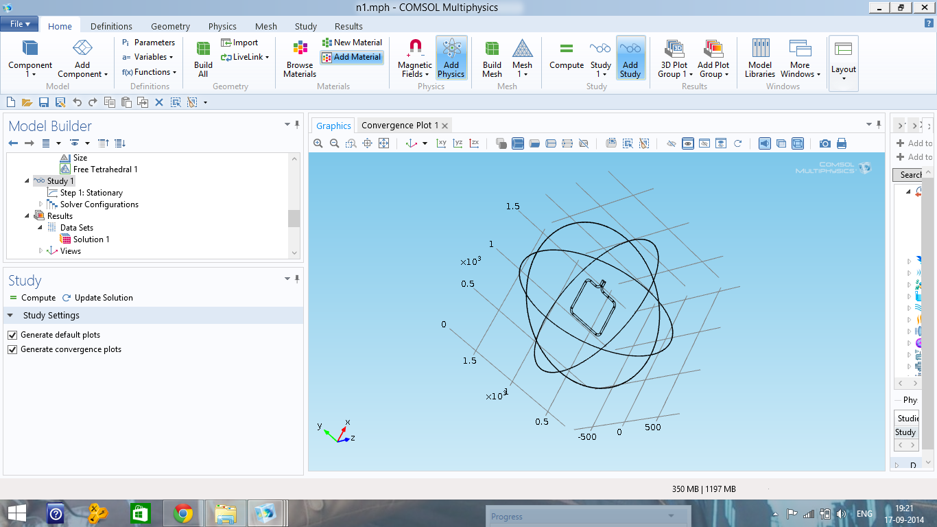

Could not find any Cartesian regions.
- Feature: Infinite Element Domain 1 (ie1)
i am getting this msg from comsol 4.4 .
my aim is to get magnetic feild lines from a conductor in a shape of a square coil,for that purpose i made a sphere for the infinte domain , i mentioned the materials as copper for coil and air for the surrounding area of coil , can someone please mention possible reasons of failure.i have attached the screenshot of my model for reference.
thanks in advance,
jyotirmaya ojha

You have probably set the infinite domain to cartesian but need to set it to spherical.
Cheers
Edgar
