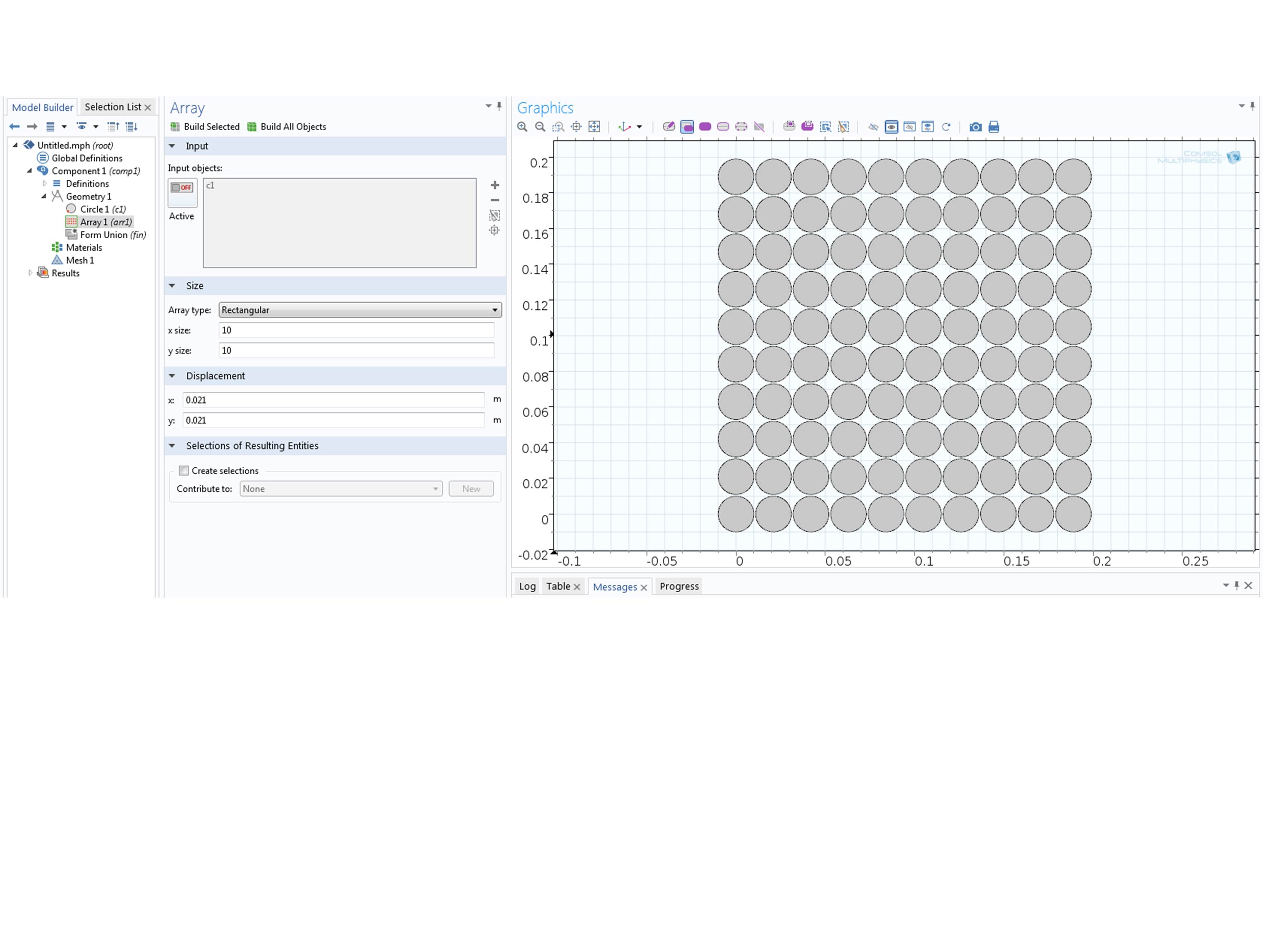

Use an array. Screen capture attached.
BR
Lasse
Use an array. Screen capture attached. BR Lasse

Thanks for the response; however, I need to build a list of circles in specific locations. The circles will not be in an ordered array, but rather distributed in "random" locations. I may need to use MATLAB, but I was unaware if COMSOL can directly import a list of x,y coordinates and use those to define circle locations.
Cheers
Hello, Thanks for the response; however, I need to build a list of circles in specific locations. The circles will not be in an ordered array, but rather distributed in "random" locations. I may need to use MATLAB, but I was unaware if COMSOL can directly import a list of x,y coordinates and use those to define circle locations. Cheers
