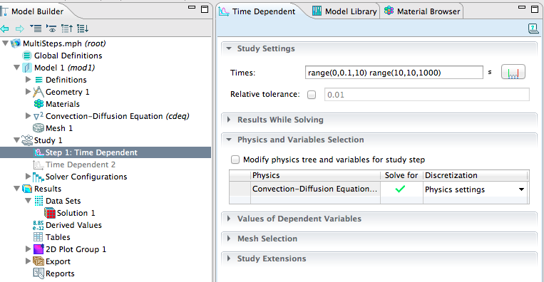

Posted: 1 decade ago 2 mars 2014, 09:31 UTC−5
Hi Huang,
I think that the problem is that you insert 2 different time steps.
Try to use only one (STEP 1) with the range set as in the picture and disabling STEP 2.
It should works now.

Hi Huang, I think that the problem is that you insert 2 different time steps. Try to use only one (STEP 1) with the range set as in the picture and disabling STEP 2. It should works now. -- Marino Miccio Chemical Engineer http://marinomiccio.wix.com/home
