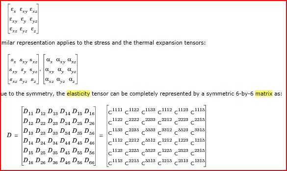

Has anyone experienced such a problem so far?
have you tried to define the material as anisotropic , in the physics node ?
Yes, I did. but the anisotropic elasticity matrix still assumes symmetrical tensor. What I need is to define all the elements separately.
for example in my case s12 is not equal to s21.
36 elements for elasticity matrix still gives us 6 elements of the symmetrical stress tensor.
For a 3*3 stress tensor, I need to define all 9 elements separately. in my case s12 and s13 is not equal to s21 or s31.

Just select "Equation View", then you can input directly all 36 elements of the elasticity tensor with whatever you want.
You are right, hadn't fully noticed that, and internally it stores only the half of the elements (check the equation view)
You can certainly define them, but then you must enter their values all over in "all" formulas,
The way rebuild your fully anisotropic physics with the "model builder" but that would take some time (I still havent manage to find enough time to learn that feature of COMSOL)
Other way ask support ;)
A material with unsymmetric stress tensor ("Cosserat elasticity") is rather uncommon, and cannot be modeled using the built-in functionality in COMSOL Multiphysics. All operations assume a symmetric stress tensor.
You can implement it on your own, using either the Physics Builder (as suggesteed by Ivar) or just weak form PDE:s.
There is a paper written about such an implementation:
Jena Jeong and Hamidreza Ramezani: Implementation of the Finite Isotropic Linear Cosserat Models based on the Weak Form. (COMSOL conference 2008)
www.comsol.com/papers/5073/
