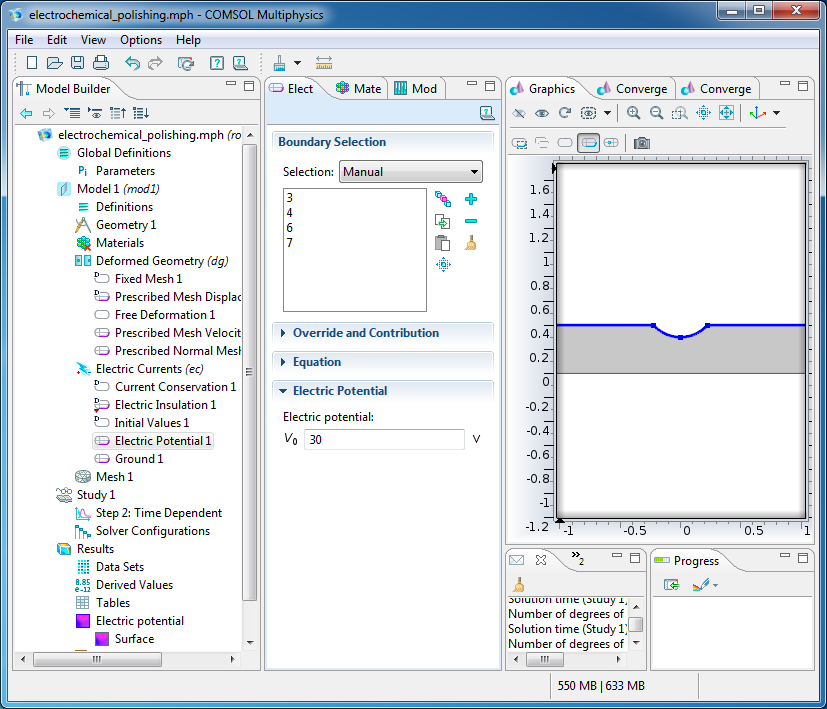

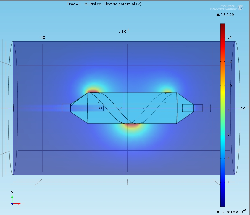

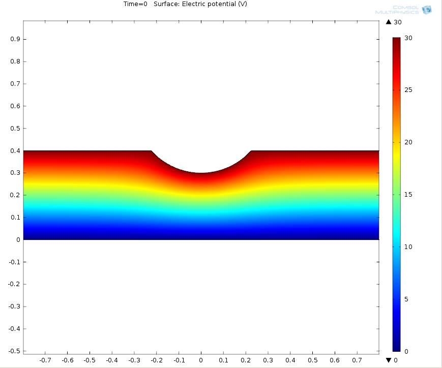

I was surprised to find that when my model is plotted at t=0, the electric potential that I apply appears. I was assuming that at t=0, V =0. My initial value for V is zero.
This does not seem correct to me. I find the same thing in the electrochemical_polishing.mph model from the COMSOL Model Library.
I have attached screenshots of both models.
Seems to me that at t=0, V =0, correct? Also, at what value of t does the solver apply the electric potential?

check your initial conditions, if you "solve for initial conditions" your V is probably =0, but if you have set it at t>0 to some other finite value, the results for t=0 will not be fully clean, as the time derivative must be respected and if you have a Dirac at "t=0" it will flow over in the final response. use rather a ramp of short rise time, and you will get V=0 at t=0 in your solutions too
Electric potential boundry condition is set to Vo = 30 V, in this instance in any time V non equal zero.
Set Electric potential boundry condition Vo = 0 in t = 0 and enjoy.
This is a misunderstanding. The initial values you specify in the Comsol physics interface are simply start values for the solver. You can think of it as the "first guess", which the solver takes and then starts iterating until it converges to the solution (as defined by the partial differential equations and the boundary conditions). This should not be confused with the meaning of "initial value" in "initial value problem", which refers to solving a differential equation (usually an ODE) for a given initial condition (at t0, but not necessarily at t0 = 0).
If you have an "Electric potential" boundary condition in a time-dependent problem and enter a simple constant (as opposed to a function of time, using the built-in time variable "t"), then this potential is applied at all times, i.e. starting at t = −∞.
If I can't get around this, I would want to control the application of the electric potential to follow an exponential ramp such as: Vrf= (Vf -V0)* 1-exp(-t/tau) where Vf is the final potential desired, V0 is the initial potential at t=0, t = time, and tau = 1 sec.
Basically you have to enter the above formula in the "Electric potential" boundary condition and define all those constants as a "Global parameter".
