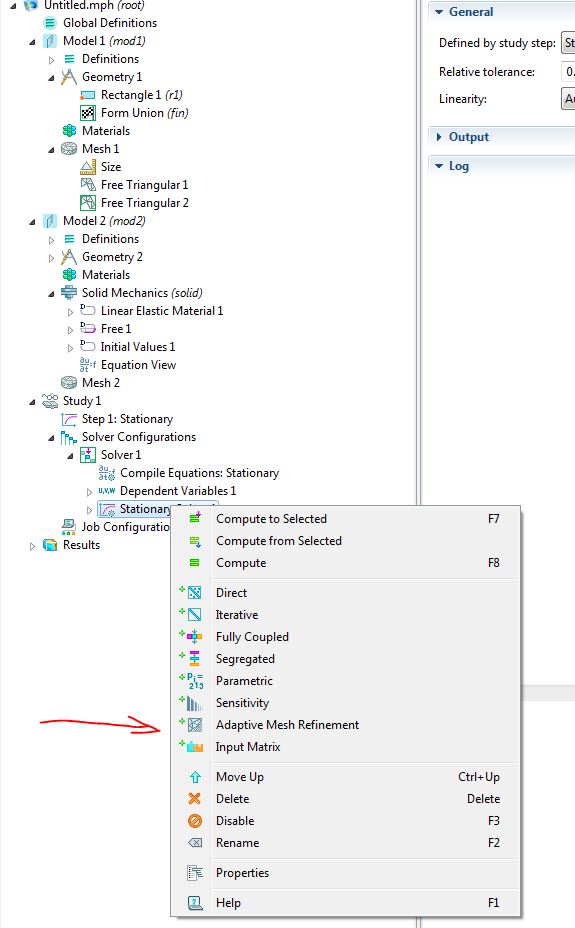

You can access the mesh commands under the solver nodes (try a right click), see also below
Hi You can access the mesh commands under the solver nodes (try a right click), see also below -- Good luck Ivar

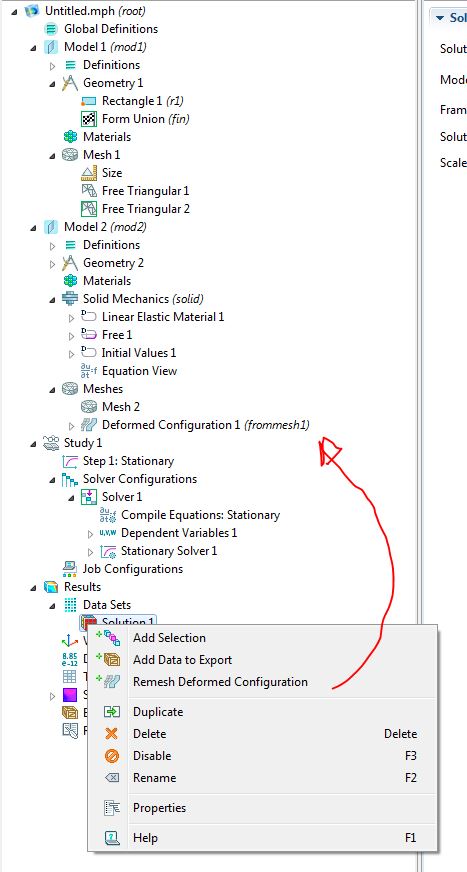

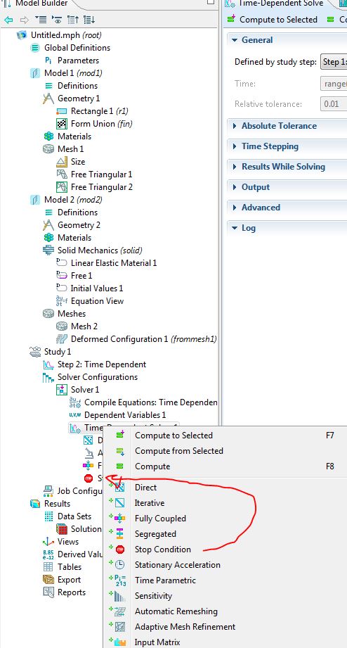

I looked at the attached images, but they refer to deformed meshes or to a time dependent solver. My problem is different, and will try to explain it a different way.
