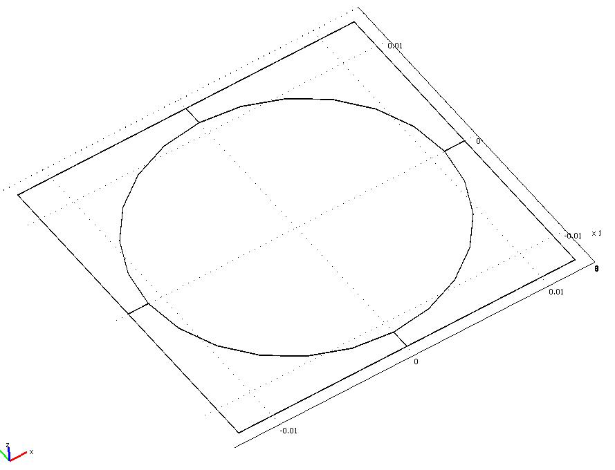

I am trying to mesh a simple thin (50 micron thickness) plate with a hole (attached image) in the center (dimensions 25e-3 x 25e-3 x 50e-6) by sweep meshing.
When I select the curved part as source and the boundary edge as target, I get an error saying that the "elements on the source and target do not match". I have same number of elements on both boundaries.
When I select the other way round, I get an error saying "invalid topology of sub-domain".
Please help.

I belive that the sweep mesh is rather for surface to surface meshing, not involving edges, in the sens that you select 1/4 top suface=boundary and you make a triangular mesh, then you select the 1/4 voume=sub domain and you do a sweep mesh along the thickness, and you repeat for the 4 quadrants, this works for me. You can also define just the top surface in a 2D workplane, and create the 3D from an extrusion meshing along the perpendicular direction.
Ther are a couple of retrictions on the sweep mesh for complex shaped object, but generally it works quite fine. Often cut up my volume with interiour boundaries to make the meshing more straighforward
