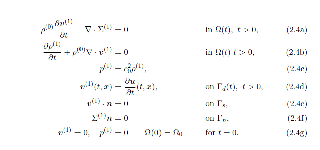

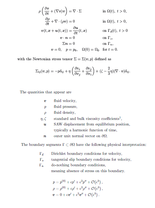

I had obtained from references the governing equations for the acoustic streaming phenomenon.....The attached "Modelling" file shows the governing equations for the problem.......But since the problem involves -acoustic and acoustic streaming effects which has different time scales....The problem was split into two- acoustic subproblem and acoustic streaming subproblem......Which involves solving first and second order equations respectively...
Now for the solution of the first order equations which gives the damped propagation of the acoustic wave. I need to solve the equations as given in "First order equations" file......
In the Fluid model in COMSOL, the continuity equations (2 terms) in COMSOL assumes the same value of density variable in both the terms but according to my problem (as seen in First order equations file). It takes one term as the steady density term and the other as first order which is different........Now would this meant that, for my problem the COMSOL Fluid model cannot be used, or is there some work around for this?
