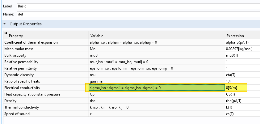

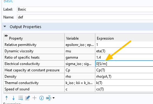

The electrical conductivity of air in COMSOL is set to zero. Could this lead to non-convergence in the simulation results? I notice that others generally avoid setting a value of zero and instead use a very small value.

Oh, thank you so much. I'm using Thermoelectric Effect modus. I think I made a mistake, just the non-triangular element is 0. Thank you for your explanition.
