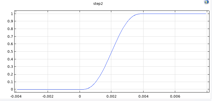

I have using a step function in a time depenedent study where I want to increase my voltage from 0 to 75V in 4 ms. For this I have given voltage by this function Voltage*step2(t[1/s]). Here my input paramter Voltage is defined as 75V.
If I understand the attached graph correctly- it means at 0.003s , the voltage will be (75*0.85 = 63.75)V Is it correct interpretation?

Yes, from your plot it looks like step2(0.003) will return about .85. If you want to know the exact value, you can have COMSOL compute step2(0.003) via a parameter.
