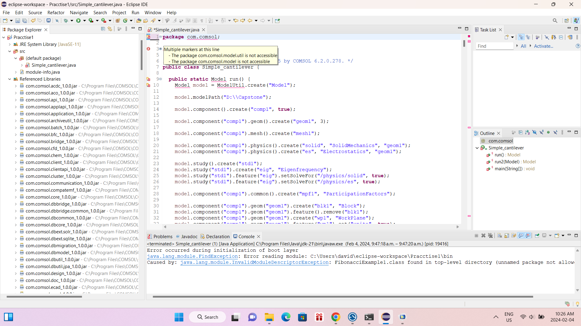

While I am trying to run a java file externally in eclips that I generated from comsol6.2 dekstop, but I am getting the error com.comsol.model is not accessible. I followed the instruction of the manual (i.e. add all the jar files, set the environment, set the security preference) but still getting error. I have attached the screenshot, please have a look.
Any help would be appreciable. Thanks.

Hi Mohammed
Remove the first line (starting with package...)
Add these lines instead: import com.comsol.model.*; import com.comsol.model.util.*;
