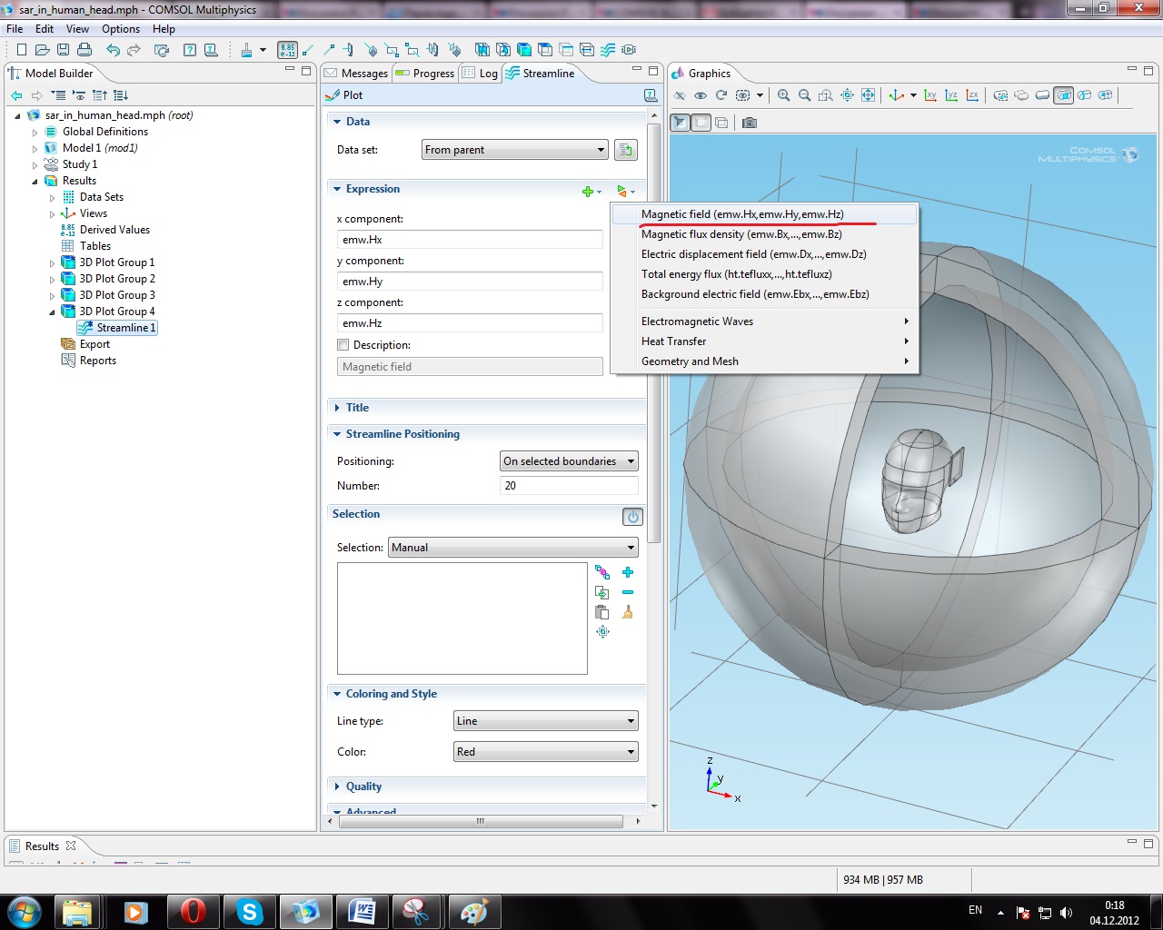

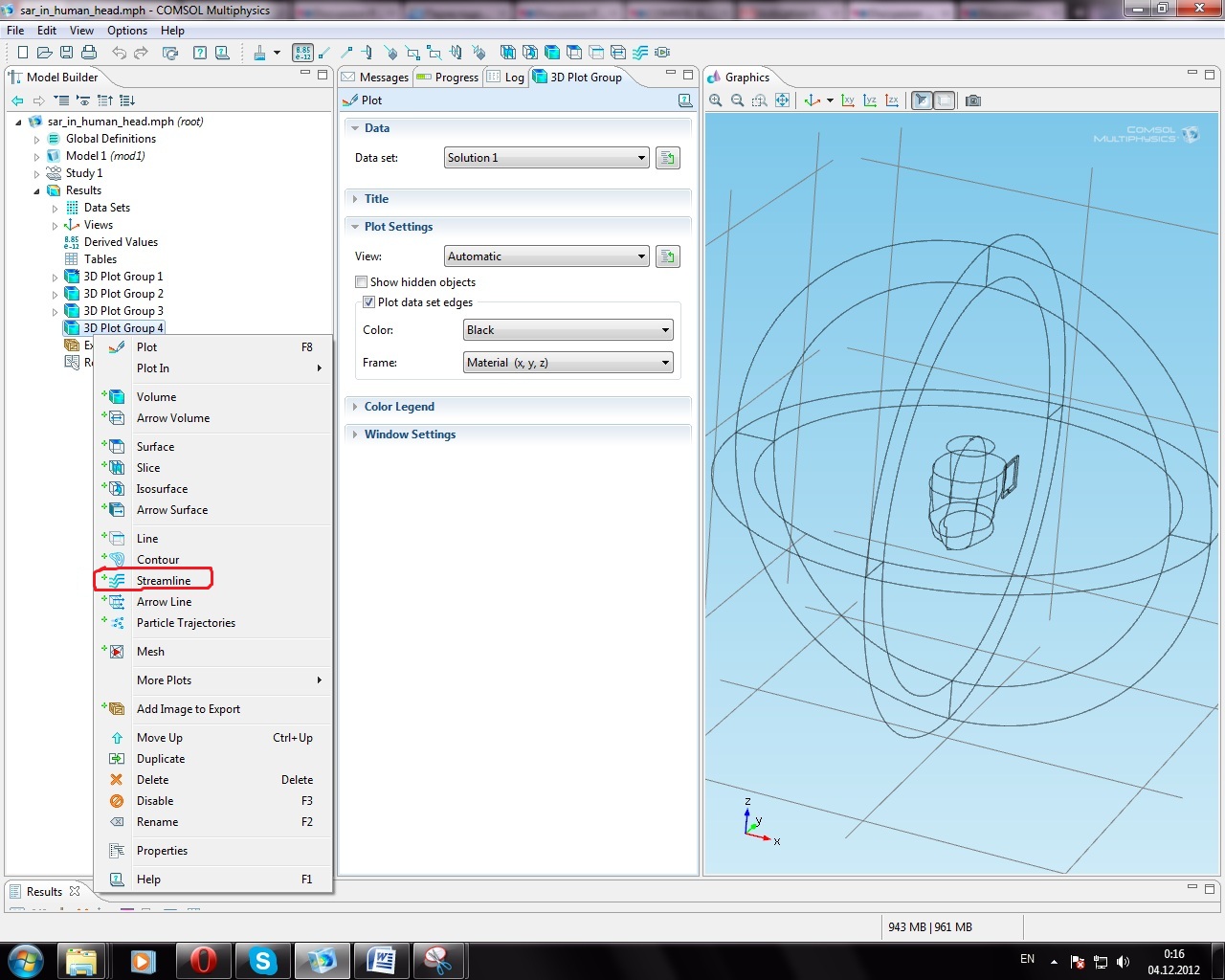

Dima,
Use the following steps to create magnetic stream lines:
1. Results>3D Plot Group
2. 3D Plot Group 1>Streamline
3. In the expression to plot, define Magnetic flux density vector {Bx,By,Bz}, or Magnetic field vector {Hx,Hy,Hz}
4. In the Streamline Positioning section, adjust streamline parameters to get nice plot for magnetic field lines
Good luck,
Sergei Yushanov
Dima, Use the following steps to create magnetic stream lines: 1. Results>3D Plot Group 2. 3D Plot Group 1>Streamline 3. In the expression to plot, define Magnetic flux density vector {Bx,By,Bz}, or Magnetic field vector {Hx,Hy,Hz} 4. In the Streamline Positioning section, adjust streamline parameters to get nice plot for magnetic field lines Good luck, Sergei Yushanov

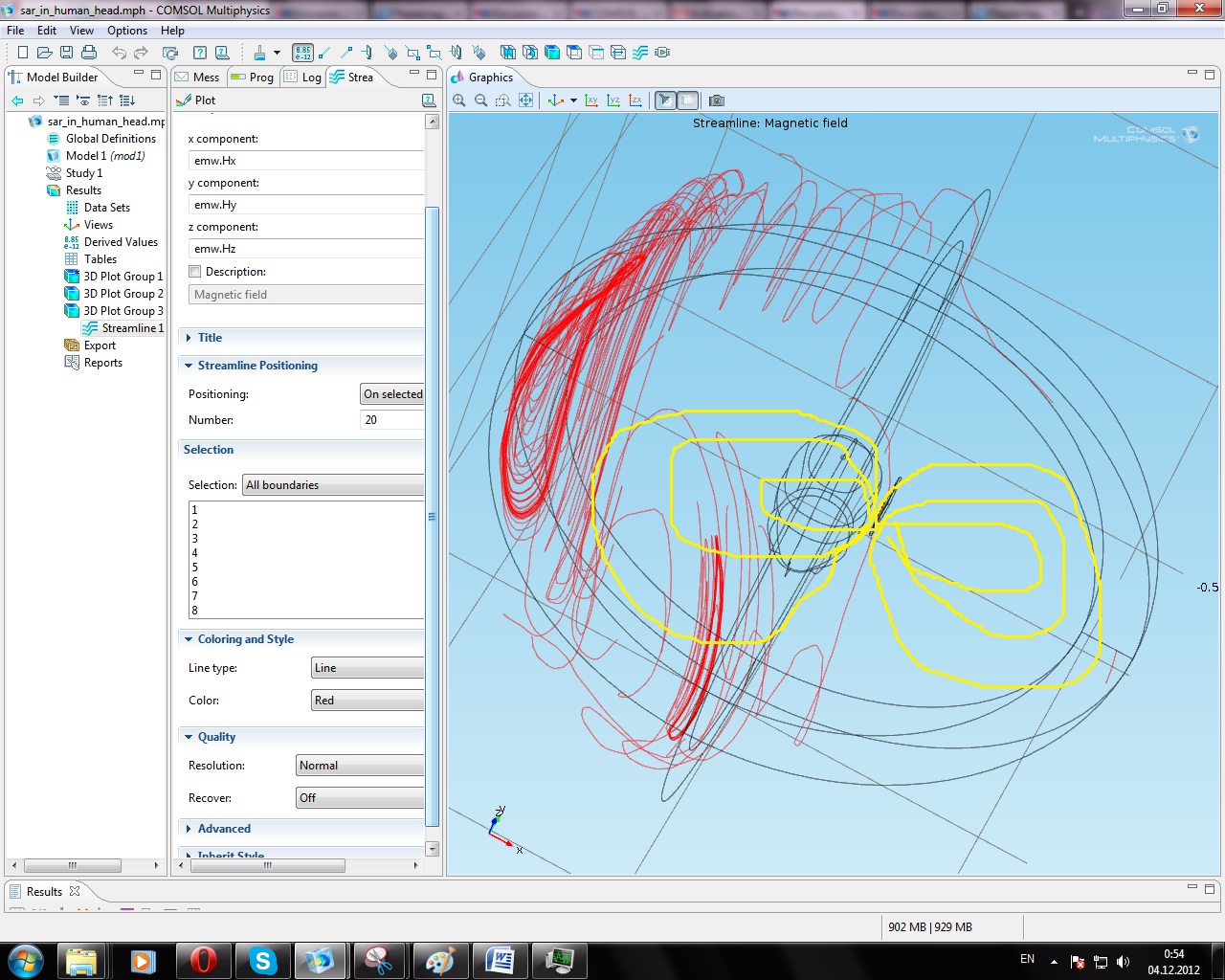

Posted: 1 decade ago 3 déc. 2012, 18:09 UTC−5
Thank you!
But I've done it before. And the result was not granted me.
Maybe I'm doing something wrong?
Thank you! But I've done it before. And the result was not granted me. Maybe I'm doing something wrong?

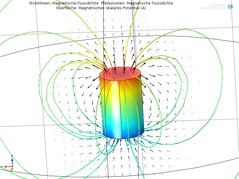

Posted: 1 decade ago 4 déc. 2012, 02:36 UTC−5
Hi!
Something like this? You can play a lot with 3D plots ;-)
Ralf
Hi! Something like this? You can play a lot with 3D plots ;-) Ralf
Posted: 1 decade ago 4 déc. 2012, 02:47 UTC−5
You must define a region (boundary) from where COMSOL should seed the generate of the streamlines, typically some place close to your source. Or you select the Uniform density streamline
Hi You must define a region (boundary) from where COMSOL should seed the generate of the streamlines, typically some place close to your source. Or you select the Uniform density streamline -- Good luck Ivar

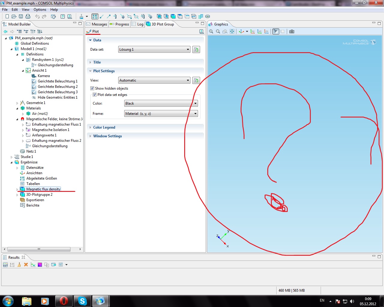

Posted: 1 decade ago 4 déc. 2012, 17:11 UTC−5
Hi!
Ralf
Hi!
Yes I want that! But somehow nothing is drawn. =(
In the graphics tab - empty!
[QUOTE] Hi! Something like this? You can play a lot with 3D plots ;-) Ralf [/QUOTE] Hi! Yes I want that! But somehow nothing is drawn. =( In the graphics tab - empty!
Posted: 1 decade ago 5 déc. 2012, 01:33 UTC−5
check the sub nodes of your plot, something is not set-up correctly, or you are not pointing to the right data set, there can be many things.
Have you gone through the doc to understand what the different tab and entries do ? usually the most important are coming first (on the top)
Hi check the sub nodes of your plot, something is not set-up correctly, or you are not pointing to the right data set, there can be many things. Have you gone through the doc to understand what the different tab and entries do ? usually the most important are coming first (on the top) -- Good luck Ivar
Posted: 1 decade ago 5 déc. 2012, 05:25 UTC−5
Hi!
I have cleared the solution to get a small file...you only have to re-run the simulation.
Ralf
Hi! I have cleared the solution to get a small file...you only have to re-run the simulation. Ralf
