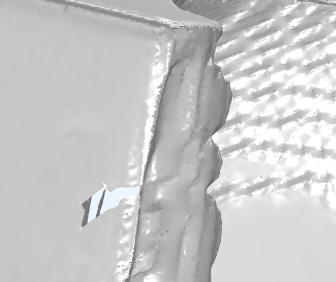

Files created by other programs and mesh parts that come with comsol don't produce good geometry, and the shape of the geometry changes, even if you don't use "Simplified Mesh".

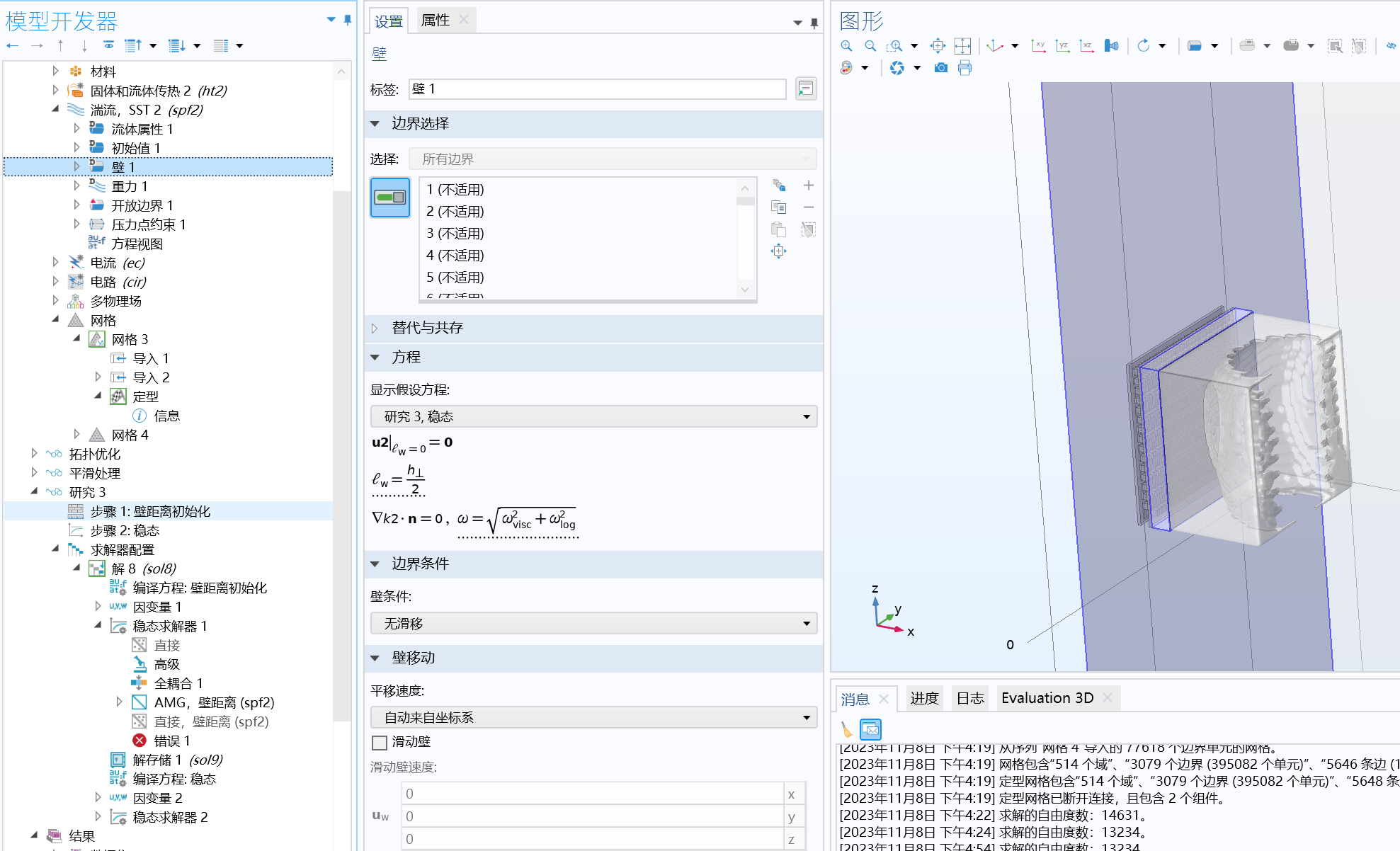

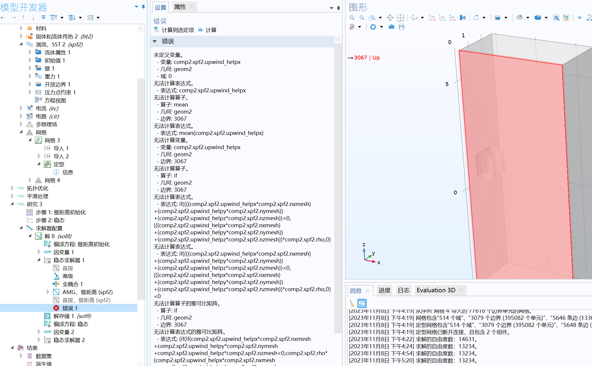

Dear Sir
I have taken your suggestion of importing the mesh part directly in the meshing sequence to validate it, but a new problem has arisen, i.e. "undefined variable: comp2.spf2.upwind_helpx; geometry: geom2; domain: 0". Boundary 3067 is the red face. I don't know how to solve this problem, can you please tell me how to solve this problem. Attached is my model tree for your reference. Thank you very much!

"Domain 0" sounds strange. I suggest contacting support about that.
