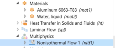

On the left, the materials dropdown menu should show what materials you assigned to the domains. Click on one of your materials (for e.g. "Air" or "Water" if you used the predefined COMSOL materials). Once you click there, you will find thermal conductivity, density and other physical properties. You will maybe see some of them expressed as k(T), where the thermal conductivity is a function of temperature (see attached picture). Nonetheless, on second thought, I do not think this is your issue. It is hard for me to say what the exact issue is, so I suggest simplifying your problem further until you find what it is. What I mean by that is: - If you have a 3D geometry go to a 2D representation and try solving it that way. - If you have a complex CAD-file, the above still holds, try sketching a simpler geometry. - Remove the heat source, and try assigning a simple temperature boundary condition at your inlet, does the model work? - Try comparing your model to this COMSOL example: https://www.comsol.com/model/heat-sink-8574. It has fluid flow and heat transfer, the physics you need. Where is the difference? (I wager the temperature in your model is not constrained) In my experience, COMSOL suggests suitable solver settings most of the time, and typically a model set-up issue (e.g. wrong/missing boundary conditions, mesh issues) is the cause. Let me know how it goes.
