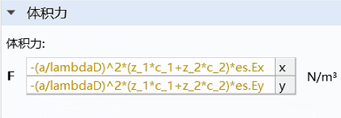

Dear COMSOL co-users, May I ask if the volume force inside the laminar flow is written correctly, or how to express the gradient of electric potential? Figure 1 is the volume force formula, and Figure 2 is my representation in COMSOL

If an entry is orange it means you have inconsistent units.
