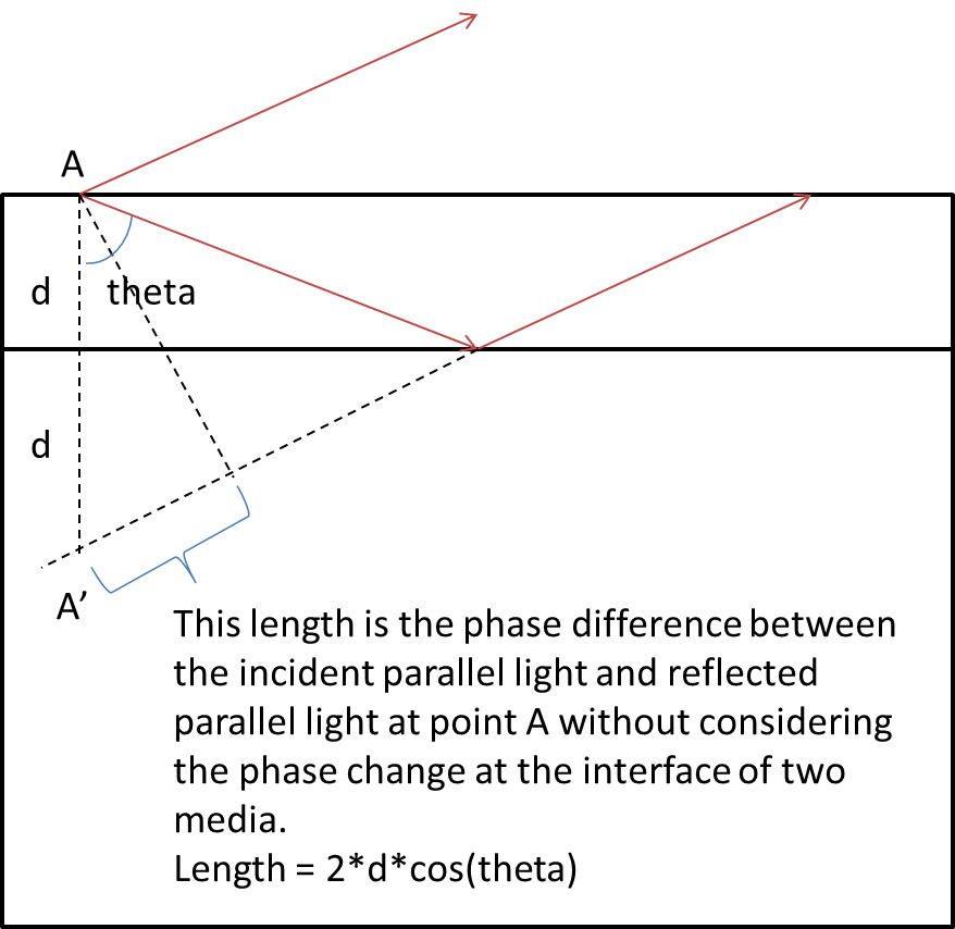

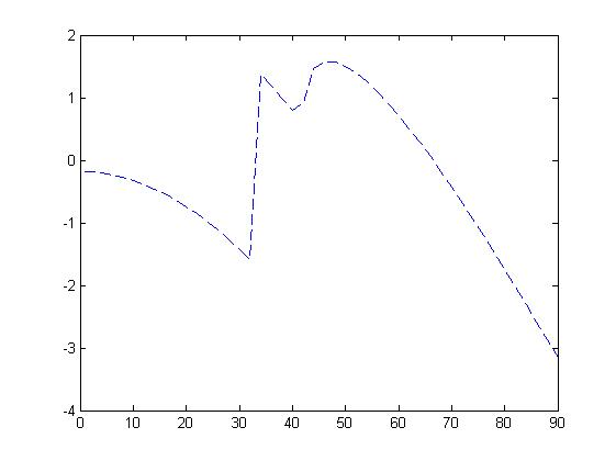

The theory I used for the analytical results of phase change is illustrated in the attachment file (Fig 'theory'). Plane wave travels in the first medium and gets reflected at the interface. If we look at point A, then the phase difference between the incident plane wave and reflected plane wave is 2*d*cos(theta) plus the phase change at the interface (fresnel's equation; phase change at the interface can be calculated by rewriting 't' or 'r' as an expression like A*exp(i*Phi), Phi is the phase change ). The analytical result of phase change is also attached (Fig 'analytical result').
My understanding is that the phase shift should be the sum of what happens at the interface between the materials (phase_interface) and what I get from the propagation to and from this interface to the port boundaries (phase_propagation). However, the results from COMSOL is the subtract rather than the sum of these two. COMSOL file is attached. (solution has been cleared because of size issue. The solution can be recovered just by simply recalculate the study again.)
