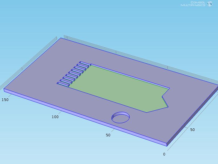

Imagine I have a substrate in which a geometrical shape has been machined into it (extruded in CAD). I want to model the fluid flow within the shape.
How can I access the shape as a "domain" within COMSOL? Consider the example in the screenshot ( I have removed a top cover for clarity). I want to assign the cut-out as my laminar flow domain and the rest of the substrate as another domain of a different material and physics. At the moment COMSOL associates everything as a single domain, so I have to model all parts as a fluid.
I have been successful in the past where I have had a shape "floating" within another shape i.e. the shape not cut-out but a shape within the larger block, then COMSOL has seen these as two separate domains.
The reason why I have not done this here is because the block has been provided to me with a cut-out and I do not want to change/redraw it.

load in your hollow geoemtry, as is, then try the cover the top area with the COMSOL Geometry "Cap Faces" and selet the boundary edges
Hi load in your hollow geoemtry, as is, then try the cover the top area with the COMSOL Geometry "Cap Faces" and selet the boundary edges -- Good luck Ivar
