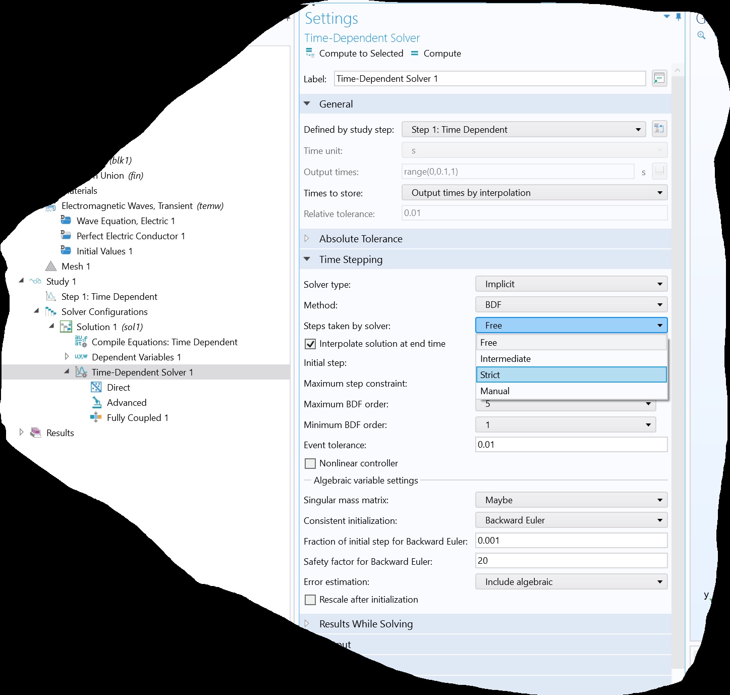

Thank you.But I do not konw how to choose the "manual" option for my time stepping, and Where to choose strict?

I've attached a picture. This example is unrelated to fluid dynamics, so do not assume any other settings shown apply in your case. Anyway, I encourage you to study Comsol's provided application examples and familiarize yourself with the best settings for various time-domain problems of relevance to you.
