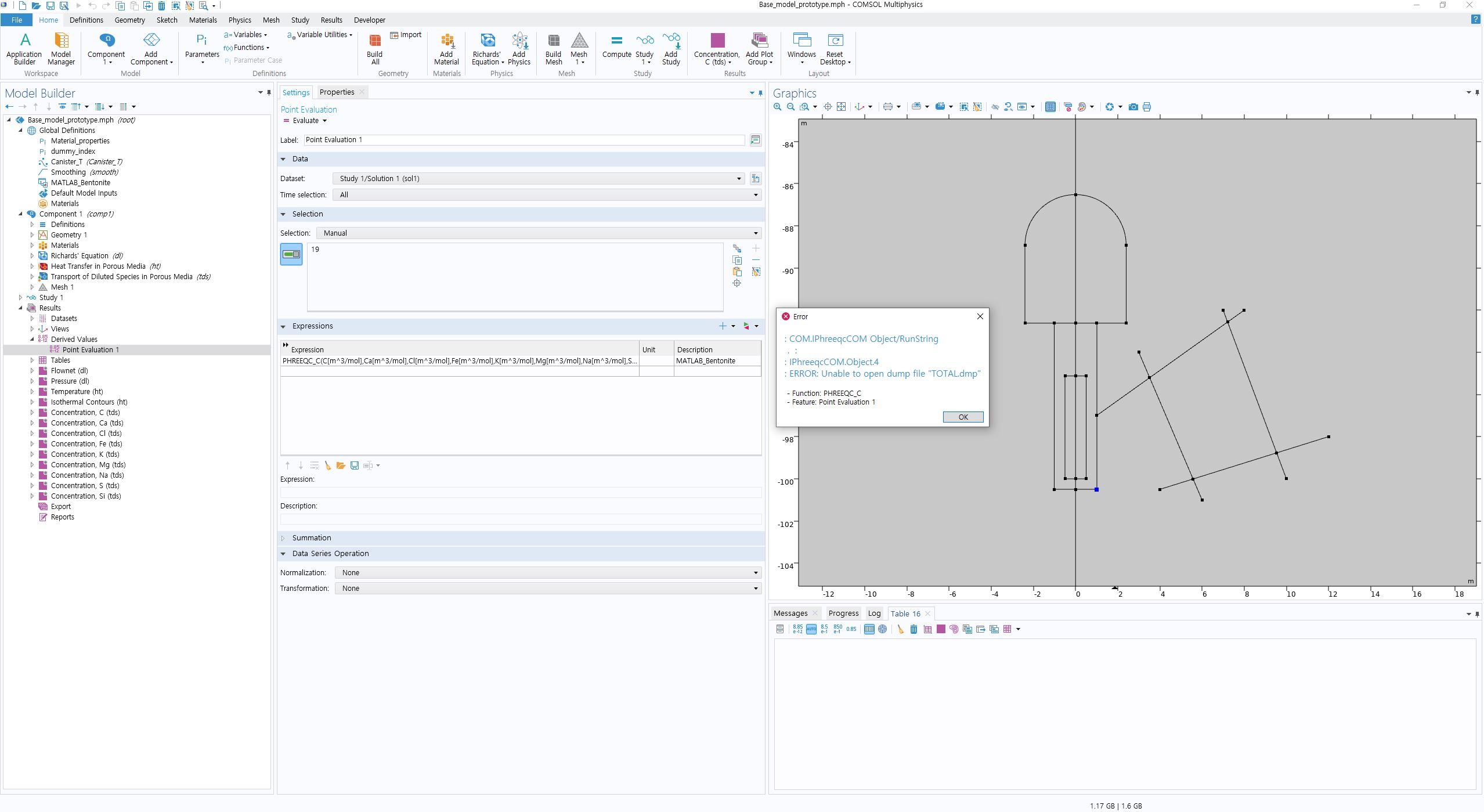

In MATLAB, I wrote a Phreeqc code based on the given information from COMSOL and saved the Phreeqc code as char variable, 'Full_text' in MATLAB. I attached the Full_text.txt, which was created by my code.
Actually, this 'Full_text' works really well if I ran it on MATLAB solely. However, when I tried to use MATLAB function in COMSOL, this 'Full_text' did not worked with error. I captured the error message and attached it.
The error message said that it was unable to open the dump file. The dump file is a kind of data-saving method of IPhreeqc, which saves the information about the result. It is necessary for solving next step calculation.
As you can see on the error message, this error was occurred when IPhreeqc was running (RunString), however, Phreeqc code (Full_text) works really well on MATLAB solely as I mentioned.
Therefore, I guess this problem is originated from COMSOL, but I don''t know how to fix this problem. Please help me with this problem.

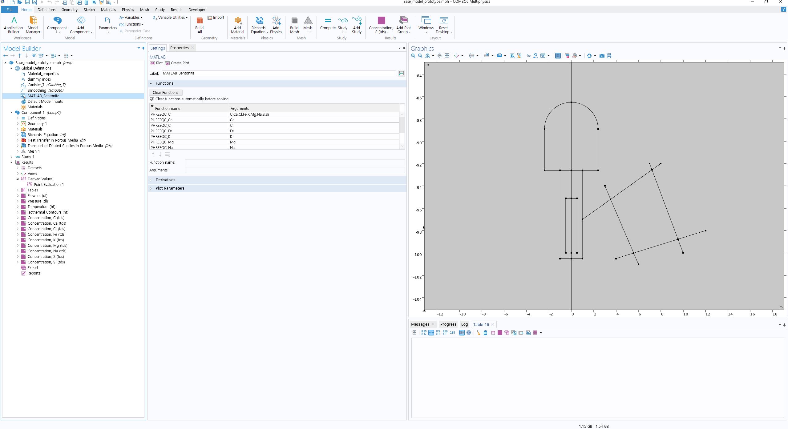

Have you written the functions such as PHREEQC_C yourself? You must make sure that these functions allow a column vector as input. If there is more than one input then all inputs are columns vectors of the same size. We do this because calls to Matlab are expensive and by calling in large batches we save time.
The problem with Phreeq not being able to write a dump file may be due to Phreeq not being able to find a place where it has permission to write the file. Perhaps there is a configuration settings you can use to change this?

First, yes I wrote PHREEQC_C function by myself. It can take column vectors as input, which I double checked.
Second, dump code in Phreeqc save the dump file in the same folder where the Phreeqc code launched. In this case, Phreeqc is launched on the MATLAB code called by COMSOL, therefore, the dump file should be saved on the folder where the .m file is.

Thanks for your reply.
Can you show the content here?
Phreeq probably doesn't know where your M-files are stored.
If there isn't a setting in Phreeq that tells it where to look for files then you could try to insert a call to the "cd" command inside your M-files to see if Phreeq responds to setting the "current directory".
