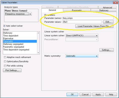

In frequency analysis how to do it for a particular frequency.where to add a frequency value

I believe in version 3.5 you can click the "Solve" menu and choose "solver parameters". It should look something like the attached image. Good luck.

Take a look at the frequency domain solver node, there you have the field for a requency or a full rnage (it's in fact a continuation sweep type operation)
But now where was that in 3.5, probbaly linked to the soler tab ...
Hi Take a look at the frequency domain solver node, there you have the field for a requency or a full rnage (it's in fact a continuation sweep type operation) But now where was that in 3.5, probbaly linked to the soler tab ... -- Good luck Ivar

I don't have it in front of me, but I think in version 3.5 you need to choose "solver parameters" from the "solve" menu. There's a shortcut key to it as well, it might be F11.
