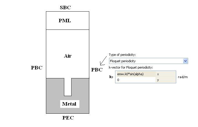

For a metal grating (see attached Structure_Reference.jpg), now I would like to analysis the dispersion relationship of surface plasmon wave supported by a metal grating, which propagates along the surface of the grating.
I choose Eigen-frequency analysis method:
I set left-right boundary as periodic boundary condition with Floquet periodicity (the related setting as well as other boundary conditions see Structure. JPG);

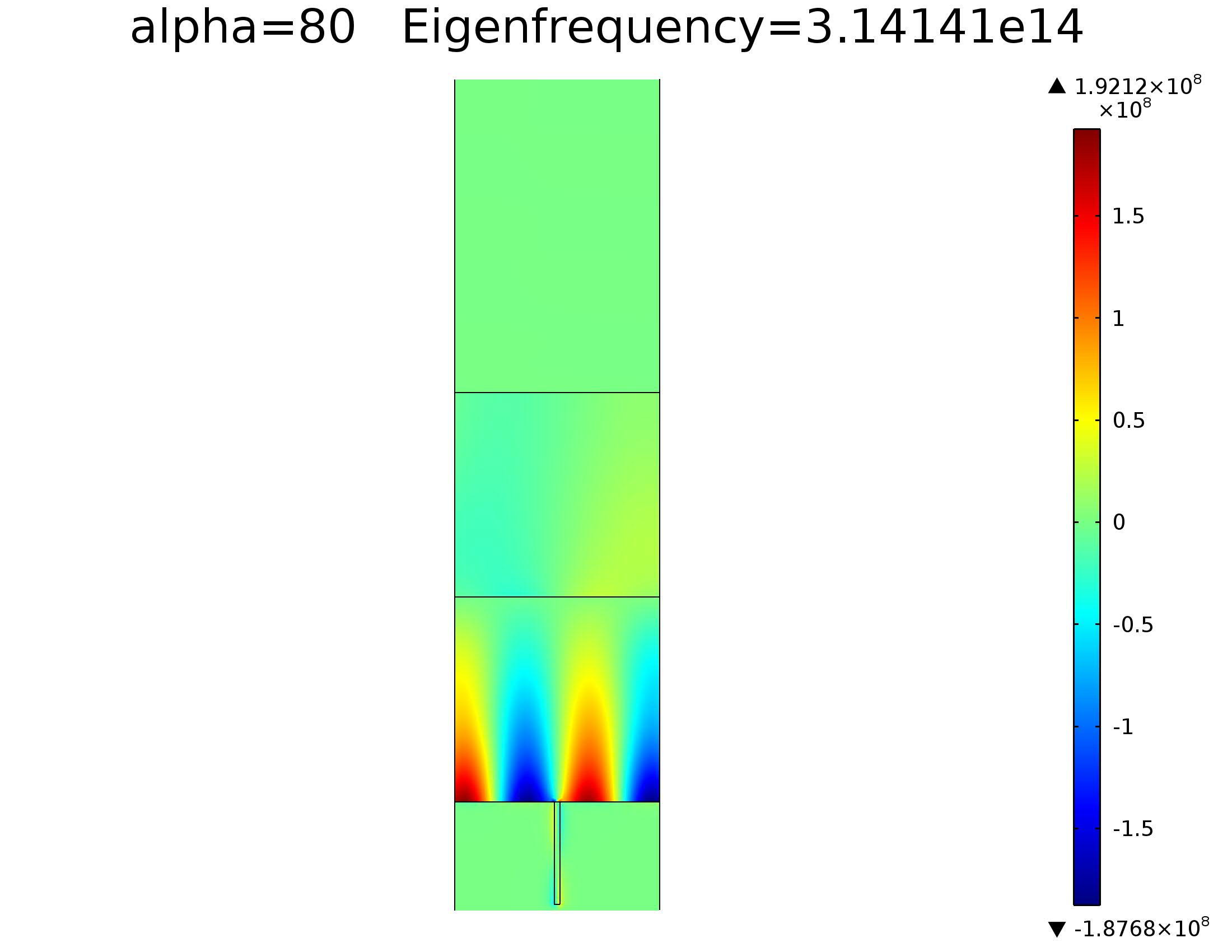

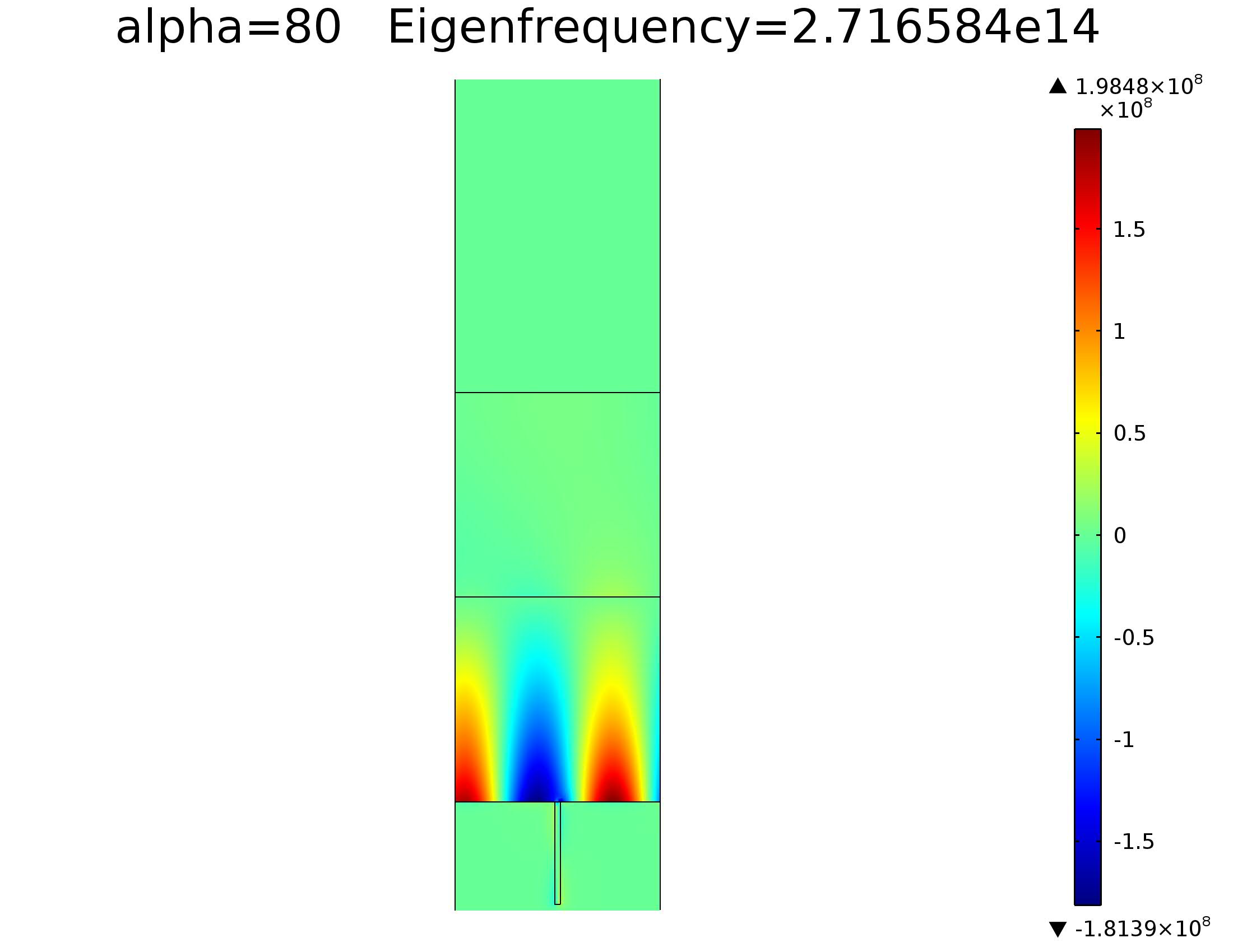

Here giving an example, when alpha is set as 80 degree, then the related eigenfrequency of surface plasmon mode is analyzed, the corresponding field distributions are see attached (a.jpg and b.jpg).
From the distributions, we can see that they are indeed the surface plasmon wave supported by the structure.
Then the dispersion relationship can be obtained simply based on these eigenfrequency values.
Above is my thought about the model.
Is it reasonable? If not, anybody could give me some suggestions?

I'd include PML on the bottom as well. Other than that, everything seems fine.

Actually, when the dimension of PML changes, the eigenfrequency changes as well, it is unreasonable.
Hi, Alexander, Thanks for your reply. Actually, when the dimension of PML changes, the eigenfrequency changes as well, it is unreasonable.
Posted: 1 decade ago 10 août 2012, 03:26 UTC−4
perhaps you PML is not 100% then, reflecting back energy, or it's too close to the grating
Hi perhaps you PML is not 100% then, reflecting back energy, or it's too close to the grating -- Good luck Ivar

Yeah the reason is that PML is close to the structure.
Yet, maybe my thought is not right, the dispersion relationship of surface plasmon wave is wrong.

another point that strikes me is that the field response is not periodic, but looks more antiperiodic w.r.t. left-right F boundaries, or have I missed a point ?
Hi another point that strikes me is that the field response is not periodic, but looks more antiperiodic w.r.t. left-right F boundaries, or have I missed a point ? -- Good luck Ivar

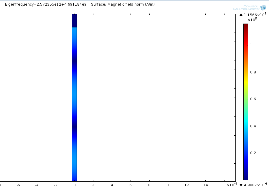

Marvin (or anyone else who may have ideas),
Can you explain in some detail how you set up that PML at the top? I'm performing a very similar simulation with a dielectric waveguide at the bottom rather than the SP waveguide and I can't figure out how to set up the PML. I've attached a screenshot that shows the upper portion of my air domain on top of the unit cell and the PML at the top. The magnetic field of one of the eigenfreq solutions is shown in the attached image. It appears as though the boundary between the PML and the air is just a PEC.
How did you define the boundaries? Is meshing important? Do you generally have to provide any inputs, or do you just add the domain, designate it PML and solve (it seems that's all they do in the tutorials)?
Any advice would be appreciated, thanks.
Chris
Marvin (or anyone else who may have ideas), Can you explain in some detail how you set up that PML at the top? I'm performing a very similar simulation with a dielectric waveguide at the bottom rather than the SP waveguide and I can't figure out how to set up the PML. I've attached a screenshot that shows the upper portion of my air domain on top of the unit cell and the PML at the top. The magnetic field of one of the eigenfreq solutions is shown in the attached image. It appears as though the boundary between the PML and the air is just a PEC. How did you define the boundaries? Is meshing important? Do you generally have to provide any inputs, or do you just add the domain, designate it PML and solve (it seems that's all they do in the tutorials)? Any advice would be appreciated, thanks. Chris
Posted: 1 decade ago 5 déc. 2012, 01:38 UTC−5
in the last version 4.3a you define the infinite or PML's under the Model Definition node
Ideally the INF region should be meshed with quad/prisms in layers, I would adopt that for MPL's too, but in any case have > 5 elements across
In older versions the INF and PML were defined under the physics, do not forget to define the shape (cartesian spherical cylindrical), and for INF at least define the origin somewhere in the middle of your model, or easier centre your model at (0,0,0)
Hi in the last version 4.3a you define the infinite or PML's under the Model Definition node Ideally the INF region should be meshed with quad/prisms in layers, I would adopt that for MPL's too, but in any case have > 5 elements across In older versions the INF and PML were defined under the physics, do not forget to define the shape (cartesian spherical cylindrical), and for INF at least define the origin somewhere in the middle of your model, or easier centre your model at (0,0,0) -- Good luck Ivar

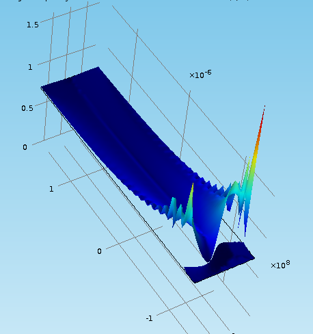

Posted: 1 decade ago 6 févr. 2015, 06:30 UTC−5
Did you try to smooth the corner of the grating? For example, using a grating of sine shape. I can reproduce your result. But when I use a sine shape grating, the field near the Floquet boundary show much fluctuations. Do you know what's wrong with my model? Thanks
