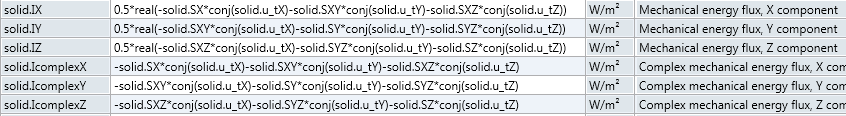

The mechanical energy flux is a vector formed by the multiplication of the stress tensor and the velocity vector. Mathematically:
The reason to have the minus sign in the definition is that if you put a pressure on an external boundary, and it moves in the direction of the load, then a positive power input in the direction of the load is obtained.
In time domain, the expression above is sufficient, but in frequency domain, there are two flavors:
The "Complex mechanical energy flux" is now the complex vector formed by the operation above, but with the velocity replaced by its complex conjugate.
The "Mechanical energy flux" in frequency domain is a real quantity; the cycle average of the "Complex mechanical energy flux"
In the appended screenshots you can see the definitions as displayed in Equation View in time and frequency domain.
Thanks for pointing out that this is not properly documented. It will be improved in upcoming versions.
Henrik
Hi, The mechanical energy flux is a vector formed by the multiplication of the stress tensor and the velocity vector. Mathematically: [math] I_i =- \sigma_{ij} v_j [/math] The reason to have the minus sign in the definition is that if you put a pressure on an external boundary, and it moves in the direction of the load, then a positive power input in the direction of the load is obtained. In time domain, the expression above is sufficient, but in frequency domain, there are two flavors: The "Complex mechanical energy flux" is now the complex vector formed by the operation above, but with the velocity replaced by its complex conjugate. [math] I_i =- \sigma_{ij} v_j^* [/math] The "Mechanical energy flux" in frequency domain is a real quantity; the cycle average of the "Complex mechanical energy flux" [math] I_i =\frac{1}{2}Re(- \sigma_{ij} v_j^*) [/math] In the appended screenshots you can see the definitions as displayed in Equation View in time and frequency domain. Thanks for pointing out that this is not properly documented. It will be improved in upcoming versions. Regards, Henrik

Thank you for the explanation, the definition (stress dot velocity) looks as people's exception for mechanical energy flux.
But in the COMSOL of my computer (COMSOL 4.3), the (complex) mechanical energy flux has the unit of W/m^3, where I saw it using "point evaluation," and it was W/m for surface integration!?
Shouldn't they be W/m^2 & W in the sense of energy flux (and also the definition)?
Where did I miss it?
Thank you!
Liu
Thank you for the explanation, the definition (stress dot velocity) looks as people's exception for mechanical energy flux. But in the COMSOL of my computer (COMSOL 4.3), the (complex) mechanical energy flux has the unit of W/m^3, where I saw it using "point evaluation," and it was W/m for surface integration!? Shouldn't they be W/m^2 & W in the sense of energy flux (and also the definition)? Where did I miss it? Thank you! Liu
Posted: 1 decade ago 24 mai 2013, 07:45 UTC−4
You are right. The unit for this quantity was wrong in versions prior to 4.3b. This does not affect the values (only the unit display) as long as results are displayed in the unit system of the model, but unit conversions will be wrong. To get the automatic unit conversion to work you can, as an example, evaluate solid.IX*1[m] instead of just solid.IX (assuming that the SI system is used).
Henrik
[QUOTE] But in the COMSOL of my computer (COMSOL 4.3), the (complex) mechanical energy flux has the unit of W/m^3, where I saw it using "point evaluation," and it was W/m for surface integration!? Shouldn't they be W/m^2 & W in the sense of energy flux (and also the definition)? [/QUOTE] You are right. The unit for this quantity was wrong in versions prior to 4.3b. This does not affect the values (only the unit display) as long as results are displayed in the unit system of the model, but unit conversions will be wrong. To get the automatic unit conversion to work you can, as an example, evaluate solid.IX*1[m] instead of just solid.IX (assuming that the SI system is used). Regards, Henrik
