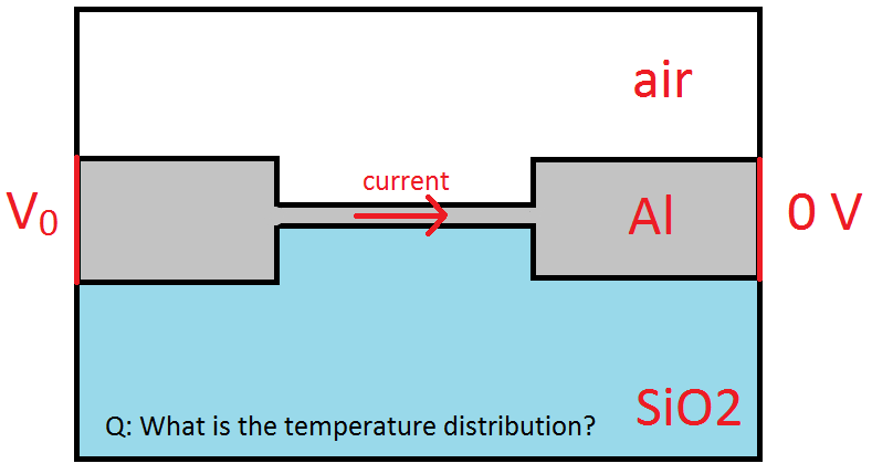

I thought it might be helpful to attach an image of what I'm trying to simulate. It is really a simple structure, just trying to find What is the temperature distribution in a thin Al sheet sandwiched between SiO2 and air, in a 2D (cross-sectional) format.
Thanks.
