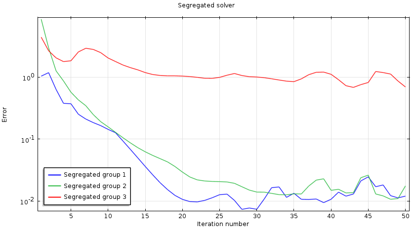

I have been trying to use the Schiller Naumann with Mixture Model to simulate a particle flow in water.
I have previously used the Hadamard-Rybczynski model with smaller particles (Rep <1) and had no problems in getting a steady convergence.
However, the Schiller Naumann is not making it easy for me.
With larger particles and higher density I get a Rep roughly in 500. So, the Schiller Naumann applies, and I can't use the Hadamard-Rybczynski model for the drag anymore.
But, I can't seem to get a convergence with the the Schiller Naumann model. I have searched the forum and found that using P=0 in the initial conditions might be the problem so I used about 2000 Pa (rough estimate) but still no convergence. I have attached the convergence plot for a better understanding.
The segregated group 1 is P,V,PHID; The segregated group 2 is k and epsilon; and The segregated group 3 is the slipvel.
Does anyone have some experiences with this or any advices?

Hello Sin Kim,
I used the mixture model with some modifications, and thus I had some issues with convergence.
If you are using the mixture model, with the Schillher-Naumann slip model, I have found that providing an estimate of the pressure drop and slipvel in the "Initial Values" really helps in the convergence process. Also, I had to use Inconsistent Stabilization for the Disperse Phase because I couldn't get a very fine mesh (due to RAM limitations of my server). In the Scaling for the stabilization I used the initial particle concentration.
Some other tips that I can provide:
- Try refining the mesh near the wall and use a boundary layer;
- Try decreasing the damping value for the segregated Newton Solver in the dispersed phase;
Hope this helps. If you would like you can upload your file and I can take a look at it.
