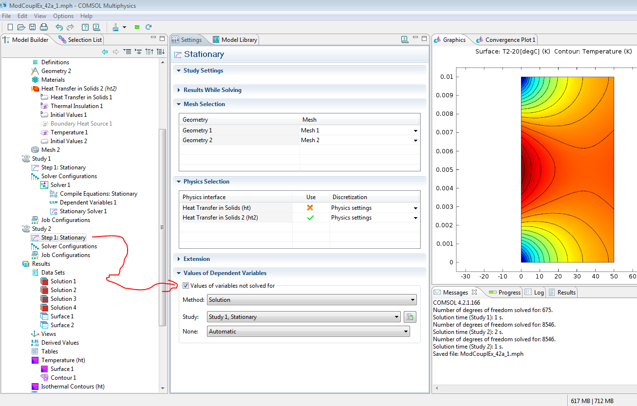

you are right that was 4.3, but you are lucky I still have a 4.2a running here it is
Do not forgget to use the solver 2 stationary node bottom: turn on the Values of dependent variables to point to the first simulation
I hope its more or less what you wanted ;)
Hi you are right that was 4.3, but you are lucky I still have a 4.2a running here it is Do not forgget to use the solver 2 stationary node bottom: turn on the Values of dependent variables to point to the first simulation I hope its more or less what you wanted ;) -- Good luck Ivar

if you look carefully I do map it to the lower surface, but I map it also to the initial conditions of the lower 3D domain. But you should be able to do the same to another BC, no ?
