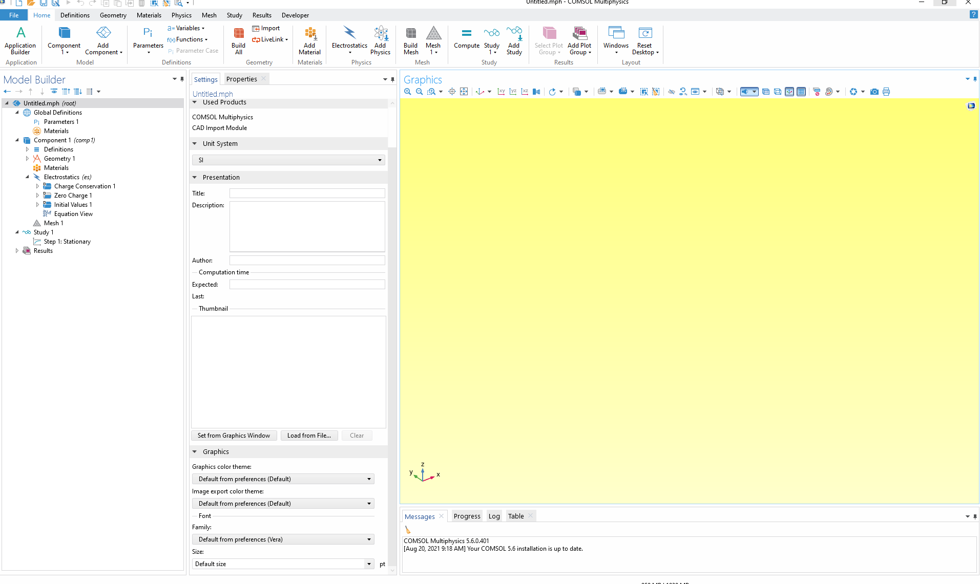

For even more control: You can change the background to be a top-to-bottom gradation between two arbitrary colors by editing the target of your COMSOL icon to read something like this:
"C:\Program Files\COMSOL\COMSOL56\Multiphysics\bin\win64\comsol.exe" -Dcs.canvascolor=255,255,120,255,255,204
where 255,255,120 is the RGB codes for the color you want at the top and 255,255,204 is the RGB codes for the color you want at the bottom. These particular numbers will give you the slightly graded yellow background in the attached screenshot. White is 255,255,255.
