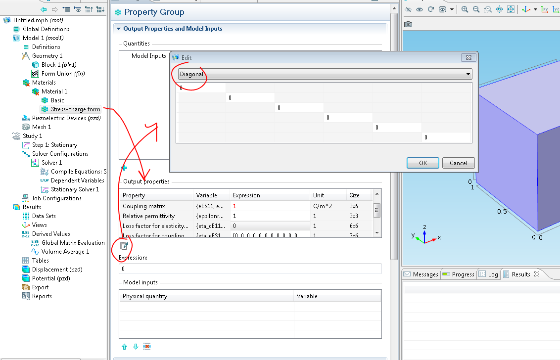

Thanks Ivar, that's a good idea. However, how can I see the tensor in matrix form?
Thanks,
Silviu.
Hi, Thanks Ivar, that's a good idea. However, how can I see the tensor in matrix form? Thanks, Silviu.
Posted: 1 decade ago 16 mai 2012, 15:18 UTC−4

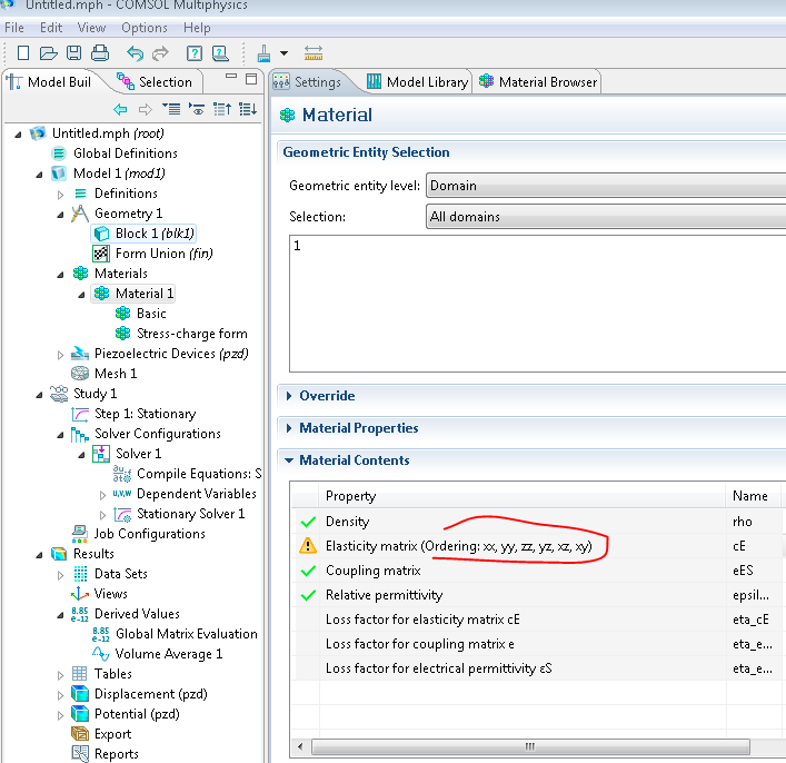

Under the material stress charge tab you have the matrix displayer / entry tool (at least in 4.2a)
And you have the ordering (PZT = IEEE convention, not the same as the standard structural !!)
Hi Under the material stress charge tab you have the matrix displayer / entry tool (at least in 4.2a) And you have the ordering (PZT = IEEE convention, not the same as the standard structural !!) -- Good luck Ivar

Hi Yang,
The order you stated is not correct. Ivar provided the correct one above. The xx,yy,zz,yz,xz,xy is just the order of the stress tensor components in the stress vector. That order goes as follows: the three normal stress components XX, YY, then ZZ, followed by the 3 shear stress components YZ, XZ, and finally XY. When it comes to entering the 21 values in the 6x6 anisotropic elasticity matrix, they go by row (or column since it is symmetric) starting at the diagonal element. COMSOL also displays a 2D array for inputting the constants and avoiding confusion about the order.
