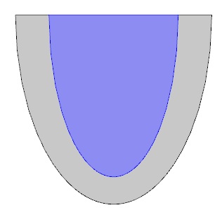

If i have a 2D geometry in half ellipse (attached .jpg), and I wish to calculate its volume (revolving volume: become half prolate ellipsoid), how can I calculate the "revolving" volume of the 2D geometry in COMSOL?
I tried to calculate using surface integration*depth (1[m]), but it does not give the expected volume, i guess it is because the "depth" indicates an extrusion rather than revolving?
(Due to some reasons, I have to use 2D geometry rather than 2D axisymmetric.)
Thanks.
Hi, If i have a 2D geometry in half ellipse (attached .jpg), and I wish to calculate its volume (revolving volume: become half prolate ellipsoid), how can I calculate the "revolving" volume of the 2D geometry in COMSOL? I tried to calculate using surface integration*depth (1[m]), but it does not give the expected volume, i guess it is because the "depth" indicates an extrusion rather than revolving? (Due to some reasons, I have to use 2D geometry rather than 2D axisymmetric.) Thanks.

if you want an ellisoid, you should use 2D-axi and not 2D, then you do a surface volume on the (r>=0) part and select use revolution to obtain volume, basically it multiplies the integration operand by 2*pi*r the "loop length"
Hi if you want an ellisoid, you should use 2D-axi and not 2D, then you do a surface volume on the (r>=0) part and select use revolution to obtain volume, basically it multiplies the integration operand by 2*pi*r the "loop length" -- Good luck Ivar

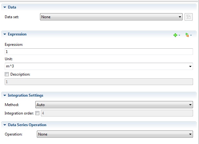

use volume integration instead
Hi Alexander,
To calculate volume by selecting volume integration, data set is required, right? What data set should I create to calculate the volume of ellipsoid?
Thanks.
[QUOTE] use volume integration instead [/QUOTE] Hi Alexander, To calculate volume by selecting volume integration, data set is required, right? What data set should I create to calculate the volume of ellipsoid? Thanks.
Thanks Ivar. Due to the implemented material properties is non-symmetric, so I choose 2D geometry rather than 2D axisymmetric (however the geometry is still in symmetry).
May I know is it impossible to obtain ellipsoid volume from calculation in 2D?
[QUOTE] if you want an ellisoid, you should use 2D-axi and not 2D, then you do a surface volume on the (r>=0) part and select use revolution to obtain volume, basically it multiplies the integration operand by 2*pi*r the "loop length" [/QUOTE] Thanks Ivar. Due to the implemented material properties is non-symmetric, so I choose 2D geometry rather than 2D axisymmetric (however the geometry is still in symmetry). May I know is it impossible to obtain ellipsoid volume from calculation in 2D?

but 2D implies an invariant along the depth direction (Z) and all items/variables dependent variables are expressed as per meter depth
It's not the same coordinate development and physics equations between 2D and 2D - axi.
I agree if your material property does not match the 2D-axi symmetry, then for me you have only true 3D left for your model
Hi but 2D implies an invariant along the depth direction (Z) and all items/variables dependent variables are expressed as per meter depth It's not the same coordinate development and physics equations between 2D and 2D - axi. I agree if your material property does not match the 2D-axi symmetry, then for me you have only true 3D left for your model -- Good luck Ivar
