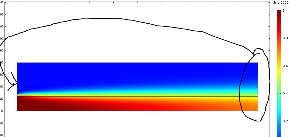

how do I take the concentration profile at the outlet from the first transport of dilute species (variable c) and use it as the inlet boundary condition for my second transport of dilute species (variable c2)?

Does it have anything to do with the inlet concentration? I am setting the inflow of a boundary to a number (i.e. 1 mol/m^3). Should this be a variable? It seems to me when I run the second study using the previous solution, the inflow boundary would still initialize with 1 mol/m^3 as opposed to the concentration at the outflow boundary from the previous study.

My way to transfer outflow concentration profile to inflow - in the next run - is presented in the attached files.
Brief description of performed operations:
1. Outflow-to-inflow-1 model was created and run.
2. Outflow concentration profile was exported to an external file conc-out.csv.
3. Outflow-to-inflow-2 model was created.
4. conc-out.csv file was imported and stored as an interpolation function (int1).
5. int1 was imposed as the inflow boundary condition.
6. Outflow-to-inflow-2 model was run.
Maybe a simpler way exists. I don't know.
Andrzej
@ Ivar, I tried using the periodic flow condition, but there wasn't really good documentation on how to use it.. Thanks for your help.
@ Andrzej, That is what I ended up doing, thanks!
I also tried using COMSOL with MATLAB, but kept getting errors, so i figured it would be easiest to just export interpolation data and use it for my next run.
