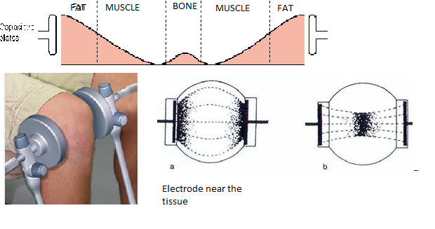

You are very helpful, thank you for it!! Problem of microwave cancer therapy I have studied, but mine is somewhat different. This is one microwave anthenna, bud i need to model two metal electrodes and tissue between. This is my geometry with some solve..
My model surround with an air box (PML)
mysharegadget.com/254275124
I know that this is wrong solve.. Because in this I have two ports and bring the wave from both side of tissue (both electrodes have port with wave excitacion). It does not behave like a capacitor. I think, that I have to bring a wave only on one electrode (+) then the wave go through tissue to a second electrode (-). For a better idea I enclose some pictures.
In material I entered permittivity and electric conductivity for 27.12MHz, in biological tissue this values ale frequency-dependent. I this model I have open end of the electrode. When they were closed, there are reflections (maybe??) Maybe is my solution and my ideas totally wrong :-(. I will be pleased with any idea..
Thank you VERY MUCH for your willingness.
Lucie
