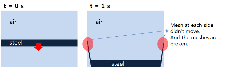

Hi, I want to simulate moving down steel in the air.
It is transient problem and I added laminar flow and moving mesh module.
The geometry is like the file I attached.
I set the whole geometry as free deformation and
set just the steel boundaries as prescribed mesh velocity of 1cm/s.
However I found that the mesh at the both side were not moved down to break the mesh.
I think it may be from bad boundary condition.
Please help.
