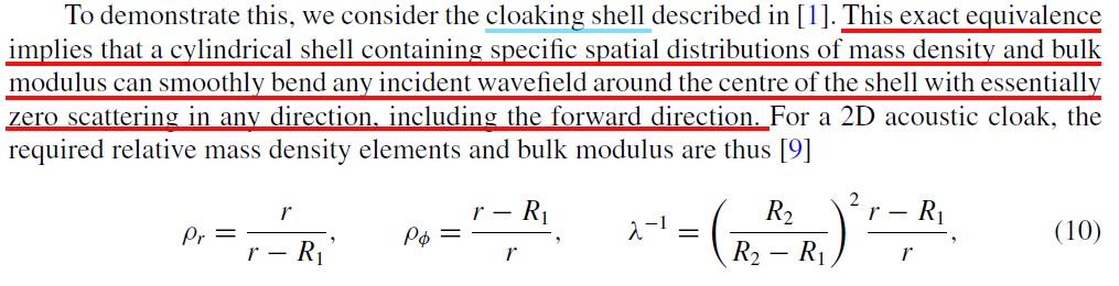

I'm doing acoustic cloaking with comsol .I know that ρ in r-direction is r/(r-R) and ρ in φ-direction is (r-R)/r. I don't know how to set these two function in material density. could you help me with this?
[QUOTE] Normally you talk about anisotropy in case directions are involved. E.g. anisotropic Youngs Modulus. This could be expressed by matrices or tensors. You probably mean non-uniform density. In this case you need to find a function that describes the density, probably as a function of location in space, find a suitable coordinate system and use this function as your expression for the density in the domain of interest. Cheers Edgar [/QUOTE] I'm doing acoustic cloaking with comsol .I know that ρ in r-direction is r/(r-R) and ρ in φ-direction is (r-R)/r. I don't know how to set these two function in material density. could you help me with this?

I'm doing acoustic cloaking with comsol . It shows that density in r-direction is r/(r-R) and density in φ-direction is (r-R)/r. I don't know how to set these two function in material density.
[QUOTE] I have difficulties understanding how a material can have a different density depending on the direction. Does that mean it weighs different depending on how you hold it? Location I understand, but not direction. [/QUOTE] I'm doing acoustic cloaking with comsol . It shows that density in r-direction is r/(r-R) and density in φ-direction is (r-R)/r. I don't know how to set these two function in material density.

I think this citation shows how to define the local density as a function of r and phi. This is what you must implement in COMSOL. So the density is a function of location and the location is in turn a function of the coordinates r and phi.
