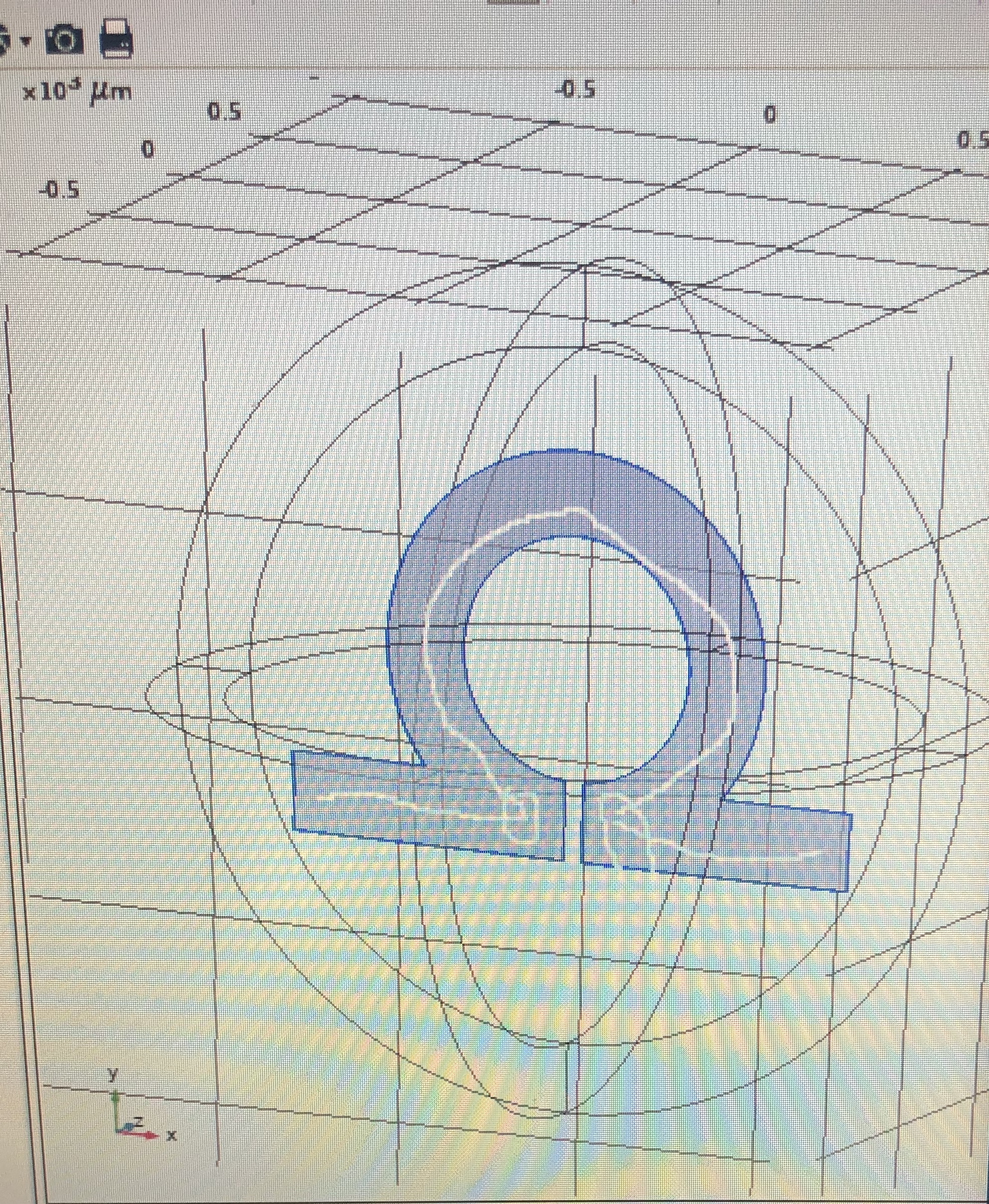

Hi everyone, Some background: I am trying to find the magnetic field of this omega shaped wire inside a sphere. I used the Electromagentic Waves, frequency domain and I am doing a frequecy domain study. Some parameters to be exact I have a current at 1 [A/m] and a frequency of 2.97e9 [Hz]. I applied a surface current density of 1[A/m](exp(i2pi/(c_const/5freq))sys2.phisys2.r where my sys2 is the given cylindrical system in the definitions. Since, my structure is irregular and has 2 straights portion and one round portion, I want to have current equal and continous at both the 2 sraight parts and the round part. I am unable to find any help anywhere. So any help is appreciated, thank you. I am attaching my mph file and a picture of how I want the current.

Hello Ayesha,
Please note that you did not attach your .mph file. Instead you attached an mph.lock file.
Hello Ayesha, Please note that you did not attach your .mph file. Instead you attached an mph.lock file. Best, Jeff
