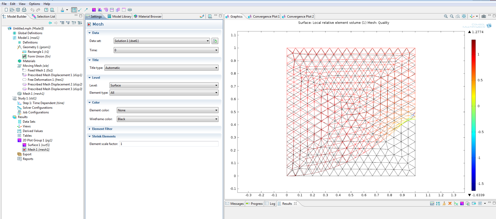

Posted: 1 decade ago 28 févr. 2012, 02:19 UTC−5
something like this ? Its not very clear (Plot Surface Quality Wireframe, smooting none + mesh at t=0
Hi something like this ? Its not very clear (Plot Surface Quality Wireframe, smooting none + mesh at t=0 -- Good luck Ivar

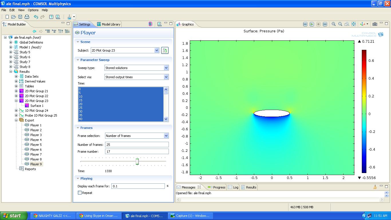

Actually, as you can see in the screen shot, at t=0 the solid body is at (0,0) and in due course of time, the rigid body is moving due to flapping (ALE prescribed motion). I want to compare the original position with the moving one (like fsi deformation where we have the reference original to see how much it is deflected).
When I veiwed it in 'geometry' frame, both initial and instantaneous positions are visible. I am not sure this is correct one..

if it was not the mesh you wanted to see, then try to add another surface plot and get the material frame pourtour at t=0 up on your screen that should leave the original "shadow"
