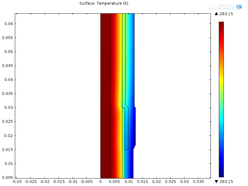

indeed I get also a strange error message, it could be an 4.0 or translation effect (I'm in 4.2a)
However the transient - stationary is OK and gives a 35 to 40 °C temperature increase depending on how you add some domains to a Heat transfer in Solid nodes.
But still I fear a very high sensitivity to the resisitivty when you mix 6E7 to 8E-16 S/m side by side
And I would advise fine mesh and boundary elements along boundaries for such large conduction changes
Check the current denity, but use a log10(jh.normJ+eps) scale (the eps is there just to see the last domain where the results is 0

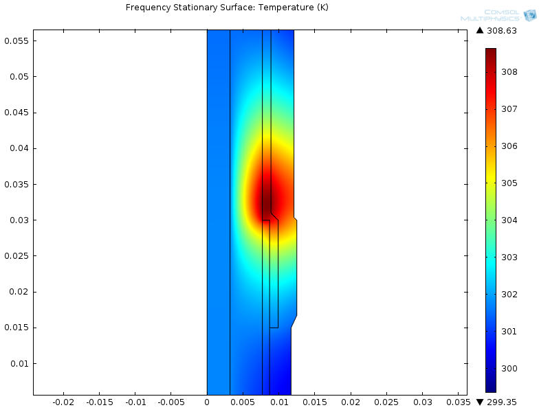

Well NO that is not working because your heating is mostly capacitive coupling at 1kHz I suppose, as I get a very different result comparing the two cases frequency-stationary and normal stationary with rms amplitude
As I'm not used to the frequency stationary (havent really ued it extensively so far) I would have to dig into the doc to find the different variables to better undersand myself ;)

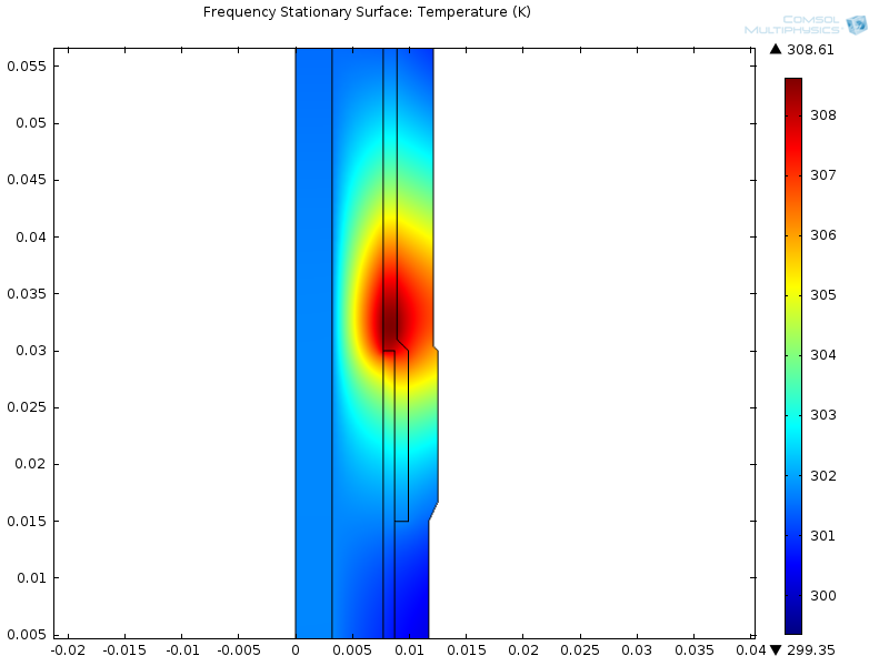

I have joined what I see, file FreqStat is your mesh in freq stationary, then I made the mesh much denser for the regions where the temperature is higest, and added boundry mesh on these 2 domains,"...Dens2", so your mesh isratherrough, ut that is easy to change once it runs ;)
If I use a RMS DV and standard stationary I get the last file, and its almost the same for all mesh density
I was a bit too quick, the finer mesh is not that much different (I had left the 1/sqrt(2))
In the mean time, I have notice that the temperature sems to e essentally dependnet ont he dielectric constatn of your first screen, which gives me the impression you are looking at the capaciative induced losses
