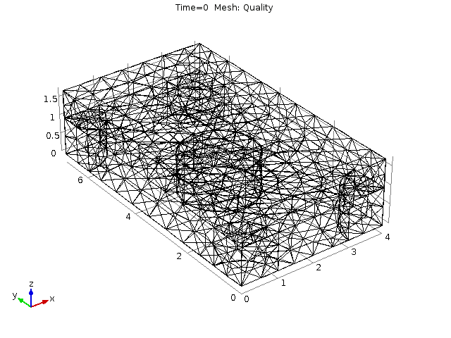

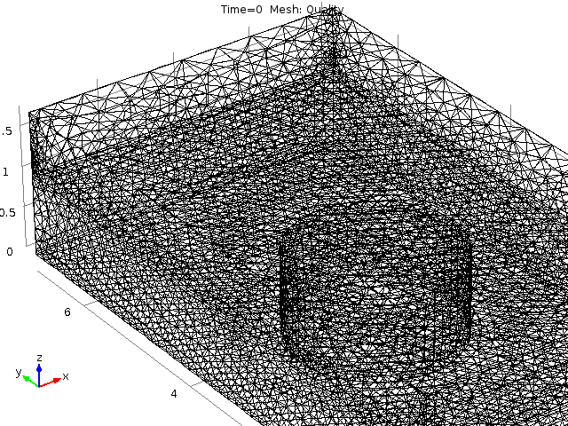

Posted: 1 decade ago 21 févr. 2012, 11:21 UTC−5
Hi Ivar,
Thank you so much for your quick reply and helpful hints. The cylinder in my case is not being moved by the fluid (it's vice versa) so fsi might not be the best choice especially since, as you said, there is no HT incorporated. I did try fsi previously though, unsuccessfuly. So I'm sticking with 1) moving mesh (ale), 2) laminar flow (spf), and 3) heat transfer in solids (ht).
I figured out my moving mesh problem! The "Zero Normal Mesh Displacement" at the bottom boundary was causing the failure to obtain consistent initial values. Oddly, when I replaced it with a "Prescribed Mesh Displacement" with only z checked as zero displacement, it worked. I thought that would have been saying the same thing, but I guess not. The "form assembly" option you mentioned works great for the heat transfer physics (with identity pair heat continuity), but when I tried assembly with the moving mesh, the cylinder moved perfectly but without affecting the mesh of the surrounding fluid. They basically overlapped each other since I guess they are viewed as separate entities in assembly mode. So for moving mesh, I have chosen "form union". I don't suppose you can define certain parts of your geometry to be "assembly" and others "union"...? wishful thinking!
Another thing, since I have boundary elements around the cylinder for the fluid flow, the mesh element quality is inherently lower. So when I added automatic remeshing, I had to lower the minimum element quality to something like 0.03 (instead of the default 0.2) in order for the solver to work. Having fluid elements in transient moving mesh makes the solver very slow though... oh well. I have attached a gif file to show the moving mesh results, which took about an hour an 15 minutes to run.

I'm not astonised you need to lower the mesh uality, even "boundry mesh elements are often thin and long, and thend to lower te "quality" that from what I understand is a measure of the "roundness" or ability to enter perfectly with all external nodes onto a sphere. Another way is to mesh separately the cylinder with a rather fine mesh, and leave the external part ina coarser mode.

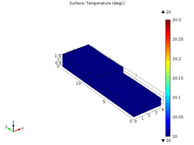

Posted: 1 decade ago 22 févr. 2012, 22:31 UTC−5
Hi Ivar,
I really appreciate your time and insight. I did some reading on the level set method you mentioned to create a "virtual solid", but I'm not really sure I want to go to that level of complexity (not yet, at least). I was afraid I was asking too much of COMSOL to do periodic moving mesh, so instead, I've made the system bigger, allowing for the movement of one unit cell of fluid + cylinders to pass underneath the plate while the original underlying unit is pushed through (see gif file attached).
I did stationary laminar flow and then transient heat transfer + ale. The laminar flow worked fine (I did with and without the periodic boundaries you mentioned with a point pressure constraint). However, the heat transfer solution looked funny to me at the boundary heat source, and this brings me back to the issue of identity pairs again. I added a pair heat continuity (with the identity pair created in assembly mode) in addition to a heat boundary source that is only supposed to occur under the plate. The heat generation is supposed to be from friction, so it should only occur underneath the plate. From the solution, it seems the identity pair created (which is plate bottom + cylinder tops) still does not allow for heat continuity between the plate and the cylinders that weren't originally in contact with the plate. Secondly, the boundary heat source is only supposed to occur underneath the wafer; instead, the cylinders that were originally underneath the plate (but are no longer) still are generating heat.
My question is: what do I have wrong with my identity pair definition, or my boundary condition definition that is causing this odd thing to happen?

Posted: 1 decade ago 23 févr. 2012, 16:45 UTC−5
Indded it looks like that the heat is continuously transferred by the cylinders onto the fixed bulk block region, as the "imprinted" region is not moving, and even when the cylinders are far away (have you turned OFF the create imprint on the Finish Assembly node ? I would have tried)
Anyhow, you have an issue here when the cylinders leave the bulk Si you have a change in topology and the entities ID's are renumbered, with the risk that COMSOL misses the correct reconnection of the BC values. Ideally the bulk part should cover the full liquid range, but then you need to adapt the material properties with some Boolean values such that the material "vanishes" (almost totally) outside the region of the true bulk Si. In this way you have no geometrical transition region and no topology change hence no element renumbering. But probably you need to use the boolean variables also on conditionally changeing the BC for the heat transfer.
Tricky case, I feel somewhat short of ideas, hopefully someone else can give some tips too (and I'm not by my COMSOL WS so I cannot test anything out like that, just now ,)
Still, have fun Comsoling
