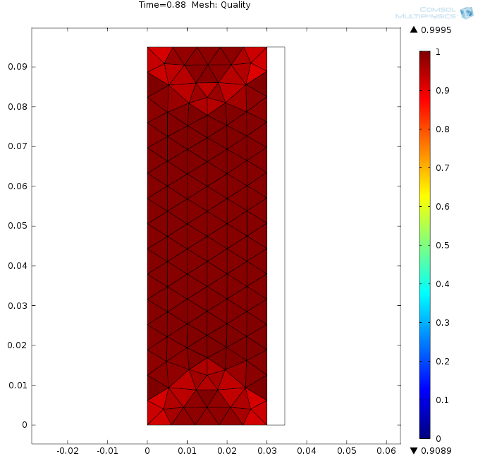

I model an axisymmetric cylinder which should expand its volume in r-direction. By using moving mesh physics>free deformation, a prescribed mesh velocity was applied at the selected boundaries.
In the result, the boundary lines (in spatial frames) did expand as what i want, however it was found that the mesh does not expanding together (as shown in the attached mesh.png).
Can anyone please tell me why the mesh did not expand? How can i make the mesh to expand together with the boundary lines (in spatial frames)?

that can come from a few issues, most probably the mesh is displayed in the material frame in the plot.
To be sure check the numerical values of a point via the different variables x, X, Xm Xg whatever you have (i.e. use a coordinate frame to list the frames variable names in 2D-axi it's probably r R Rm Rg
Hi that can come from a few issues, most probably the mesh is displayed in the material frame in the plot. To be sure check the numerical values of a point via the different variables x, X, Xm Xg whatever you have (i.e. use a coordinate frame to list the frames variable names in 2D-axi it's probably r R Rm Rg -- Good luck Ivar

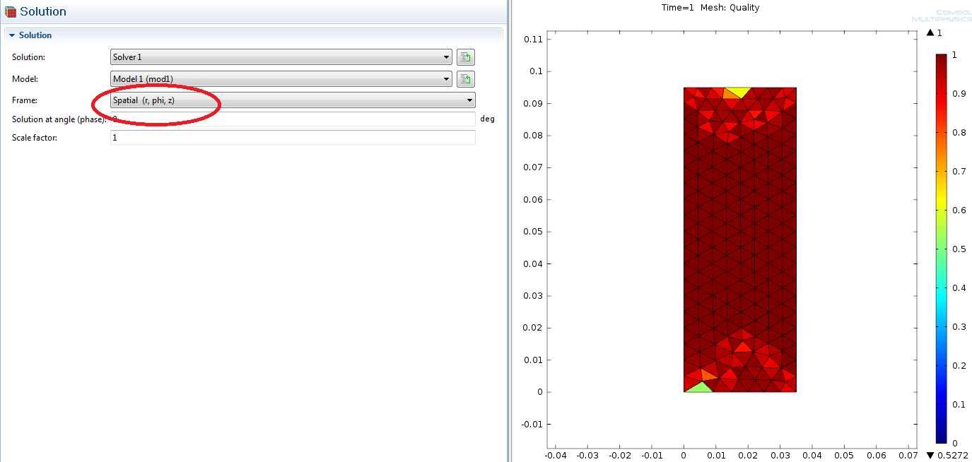

Hi Ivar,
Yes, you are absolutely right. I just realised that I should adjust the frame setting (from material to spatial frame). It works well now.
Thanks a lot for your help! :)
