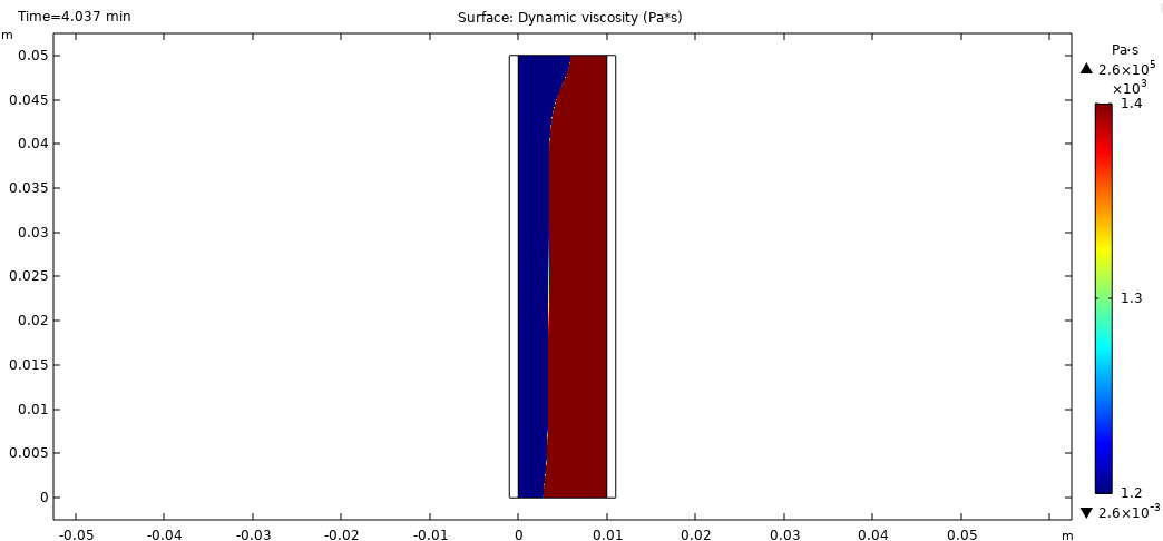

Area Calculation in a results graph
I want to calculate the ratio of blue area over the red area. How is it possible to get the surface area of this kind of plots from results.
Thanks in advance, Reza

Posted: 5 years ago 21 avr. 2020, 15:32 UTC−4
You can use the integration tools available under Derived Values. For the expression to integrate, specify a boolean expression along the lines of
quantity>cutoff_value1
or
quantity<cutoff_value2
Best,
PS: If you even want COMSOL to compute the ratio of the two integrals without having to pull out your calculator, you can instead define a Nonlinear Coupling (found under Definitions in the model tree) of the integration type. If it's the first one in your model it will be called intop1 and in derived values you'd ask COMSOL to return, in essence, intop1(quantity>cutoff_value1)/intop1(quantity<cutoff_value2)
Jeff Hiller
You can use the integration tools available under Derived Values. For the expression to integrate, specify a boolean expression along the lines of quantity>cutoff_value1 or quantitycutoff_value1)/intop1(quantity
